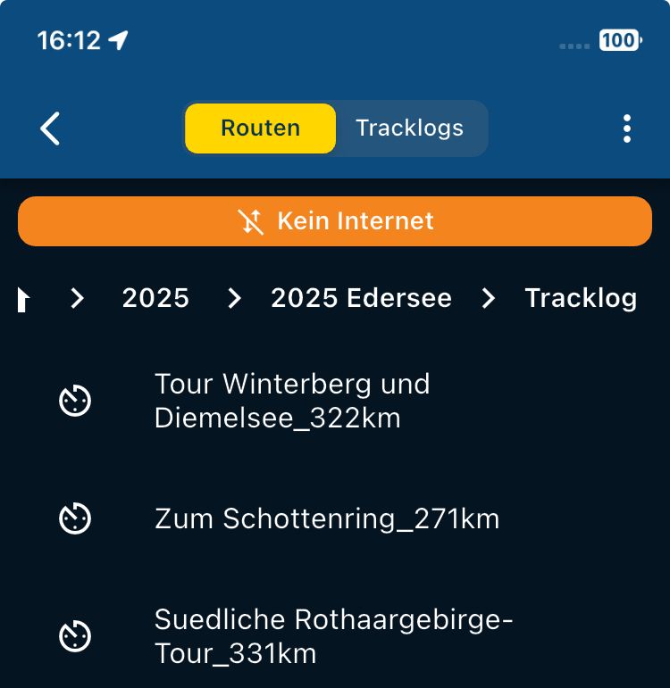

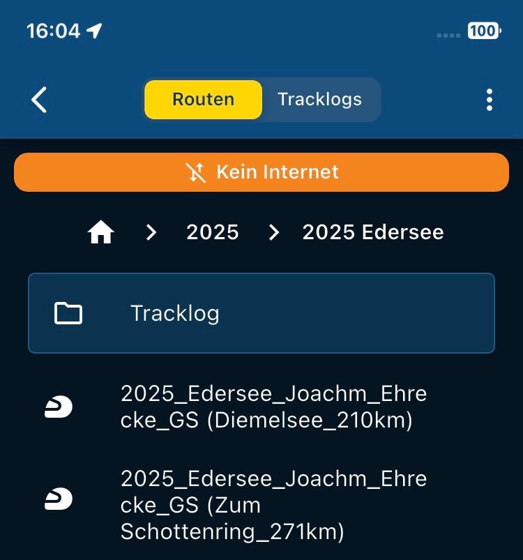

        There's a good workaround, as the tracklog folder isn't displayed when offline.
        Simply copy the important tracklogs into a subfolder under Routes, then you can use them offline as well.
        See 2025 Edersee / Routes and the subfolders there.
        • Helmet symbol = Motorcycle mode
        • Circular pointer symbol = Track
        Mann kann sich gut helfen da der Tracklog Ordner bei Offline nicht angezeigt wird.
        Einfach die wichtigen Tracklogs unter Routen in einen Unterordner kopieren dann kann man diese auch Offline nutzen.
        s. 2025 Edersee / Routen und dort Unterordner .
        • Symbol Helm = Motorrad Modus
        • Symbol KreisZeiger = Track
        One folder deeper / Ein Ordner tiefer /
          Tracklogs are not synced.
          Routetracks are synced.
          So importing tracks within your routes (as routetrack therefore) will allow them to sync.
          Syncing tracklogs just adds so much more data while rarely used offline (given the nature of all the images etc)
