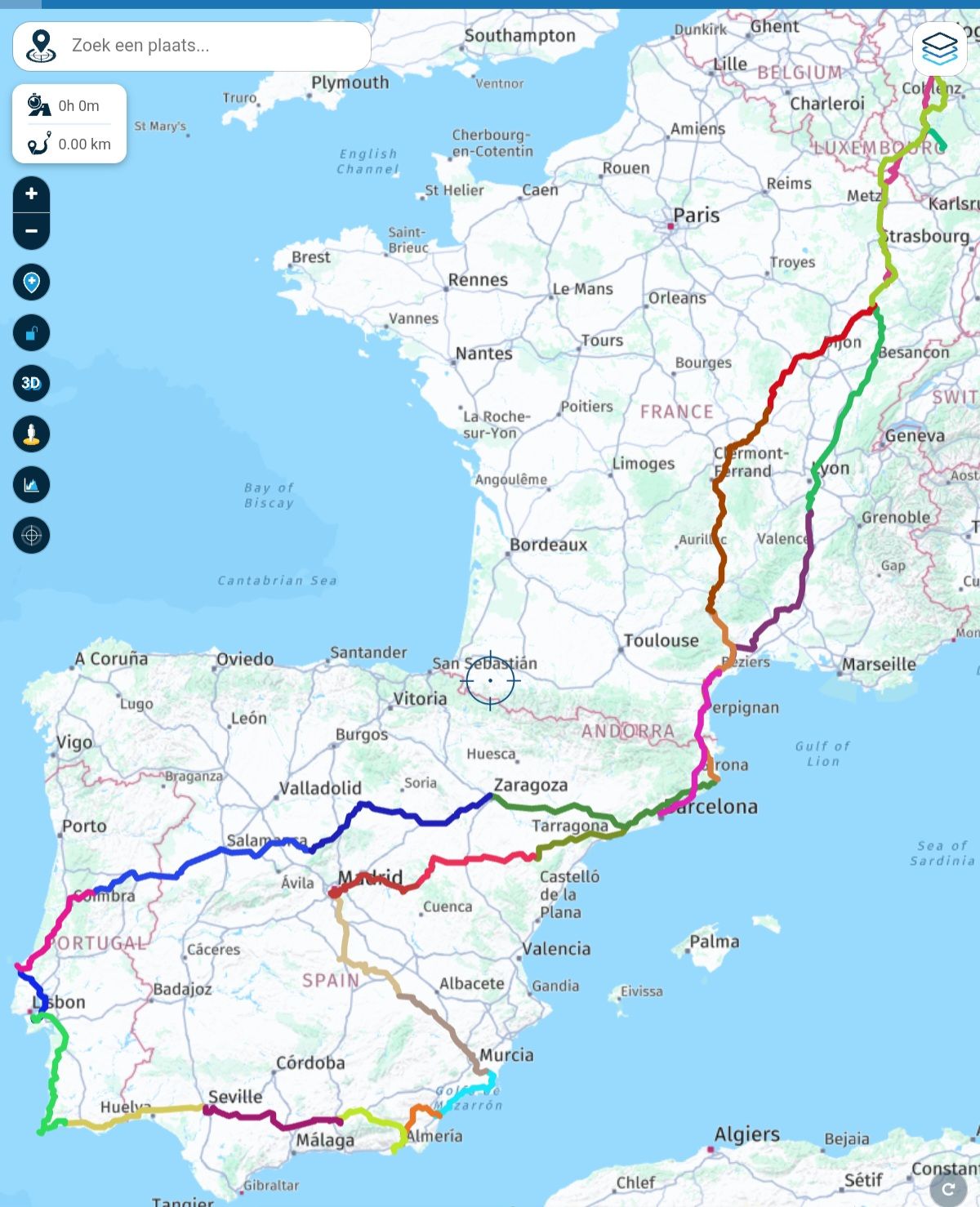

                Ok, my version 😝
                Every day has its own color.
