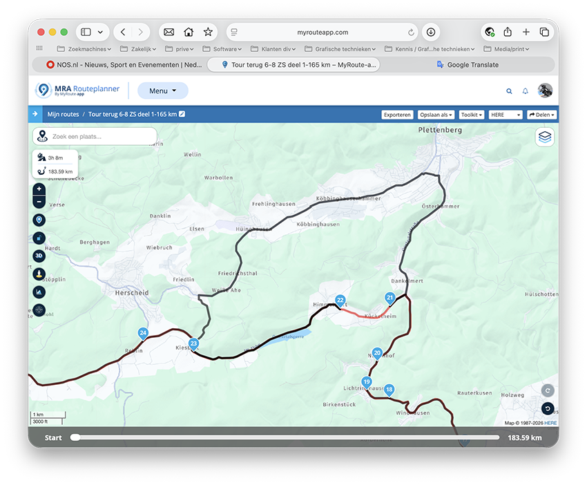

                Dear Brian, thanks for your reply, but I have enough shaping points and tried to add a few more at the location where the problem lies. But the problem persists. I hope the screenshots provide more clarity. On my ZUMO, I usually want the track under my route! I don't know if it matters, but I work on a Mac!
                Scherm­afbeelding 2026-07-24 om 17.15.55.png Scherm­afbeelding 2026-07-24 om 17.17.23.png Scherm­afbeelding 2026-07-24 om 17.17.59.png

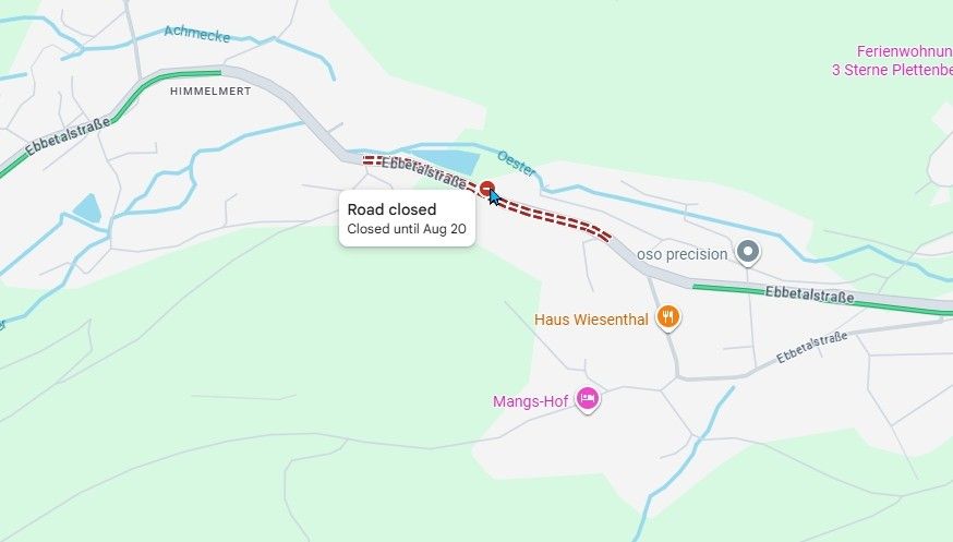

                  @Hans-Rutten According to Google maps, that section of road is closed until August 20.

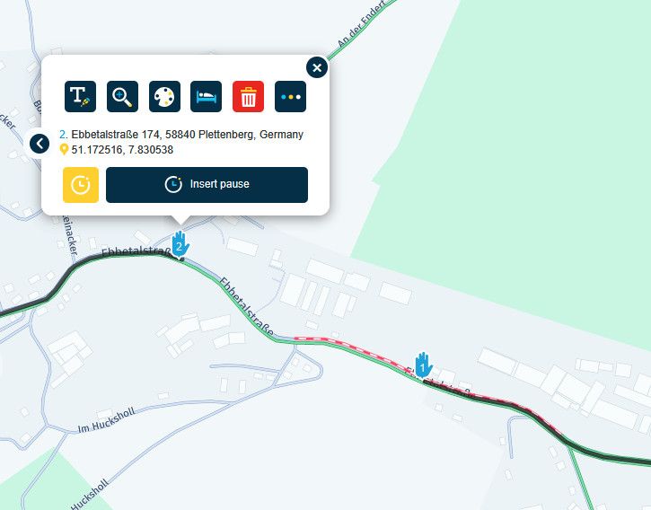

                    @Hans-Rutten as @nick-carthew says there appears to be a road closure which you can see on the Here map in MRA if you zoom in
                    If you find that the route will not pass through a certain section of road the way I test is to make a new route for just that section of road. I then move the start & end points closer together to find where the obstruction/problem lies
                    You can also toggle on/off the enable/disable "Seasonal Closure" option in the "Toolkit" to help figure out if it is a road closure

                      @Brian-McG After checking with the MRA Traffic layer I position a route point close to where the problem is and then copy the route point coordinates. I then paste the coordinates into Google Maps making sure the Google traffic layer is on. Google Maps are probably the most up to date online maps available to us although I have noted a few errors before (no one is perfect) the good thing with Google maps is they invariably give a date for the closure.
