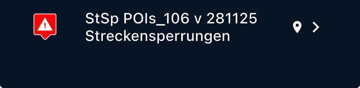

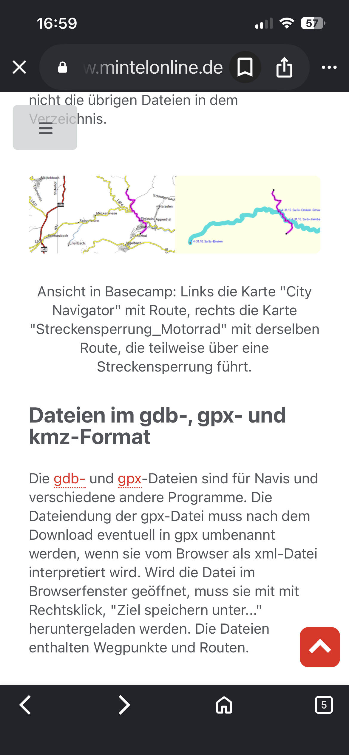

                @martin-white
                I have experienced that a public file with motorcycle closures for Germany has also caused this message.
                In the downloaded file were POI s of the signs at the beginning and at the end of the route which is okay but it was also between beginning to end a route in this file.
                I couldn't see it in MRA and loaded this public file into Basecamp, where I was only able to see it. Then deleted the routes in BaseCamp in the file and there were 106 POI left. I read this file again, and then everything was good. VG 👋
                Link to the file Klick
