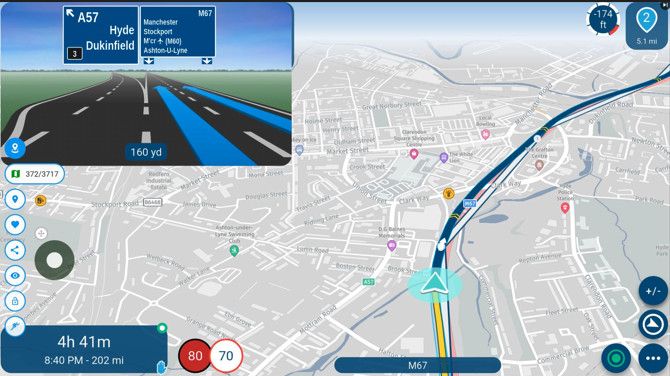

                      Hi @paul69 I have tried simulating driving your route multiple times & can't repeat the behaviour your seeing,
                      in fact I get the exact opposite, at every junction it is telling me to stay ON the m-way or main A-road
                      My guess is somehow when you started the route MRA glitched & changed a navigation setting in the background so the route was recalculated to do something abnormal
                      As @marinus-van-deudekom says this effect has been know in the past when someone created a route with the OSM route calculator but we can see in this case you have selected the Here route calculator so it is odd
                      I think the only way to try & figure out what is occurring is if you can re-ride the route & get a repeat of the issue then save the app log file for the devs
                      It looks like a decent ride to Hawick so should not be to much of a hard task 😂
                        @Brian-McG That's a nice screen! What device is this?
                        Brian McG 1 Reply Last reply
                        • LennyO LennyO
                          @Lenny-O its an android simulator on PC, not a mobile device
