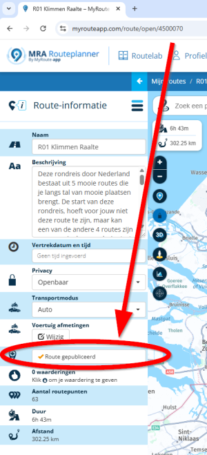

                        @Tony-Edwards-0, Check the routes that don't appear in your embedded library for this parameter!

                          Hi Con,
                          Yes I have checked this and they are all ticked orange as displayed. I did try adding an addition route this afternoon and that did not show.???? I then embedded routes from my Library for Norway and Sweden which I do not normally do until I have completed them (June 2026 adventure).
                          When doing this I noticed that some routes I have set the mode of travel for motorbike (which did not show) and other the mode was set to car (which do show) I then amended all the routes mode to car, and TA-DAH they now appear πŸ˜€ I am hoping this is now fixed πŸ˜€πŸ‘
                          MotoCon 1 Reply Last reply

                                Hi Con,
                                @Tony-Edwards-0, Ues, I can indeed confirm that Motorcycle routes are not published correctly.
                                BertM 1 Reply Last reply
