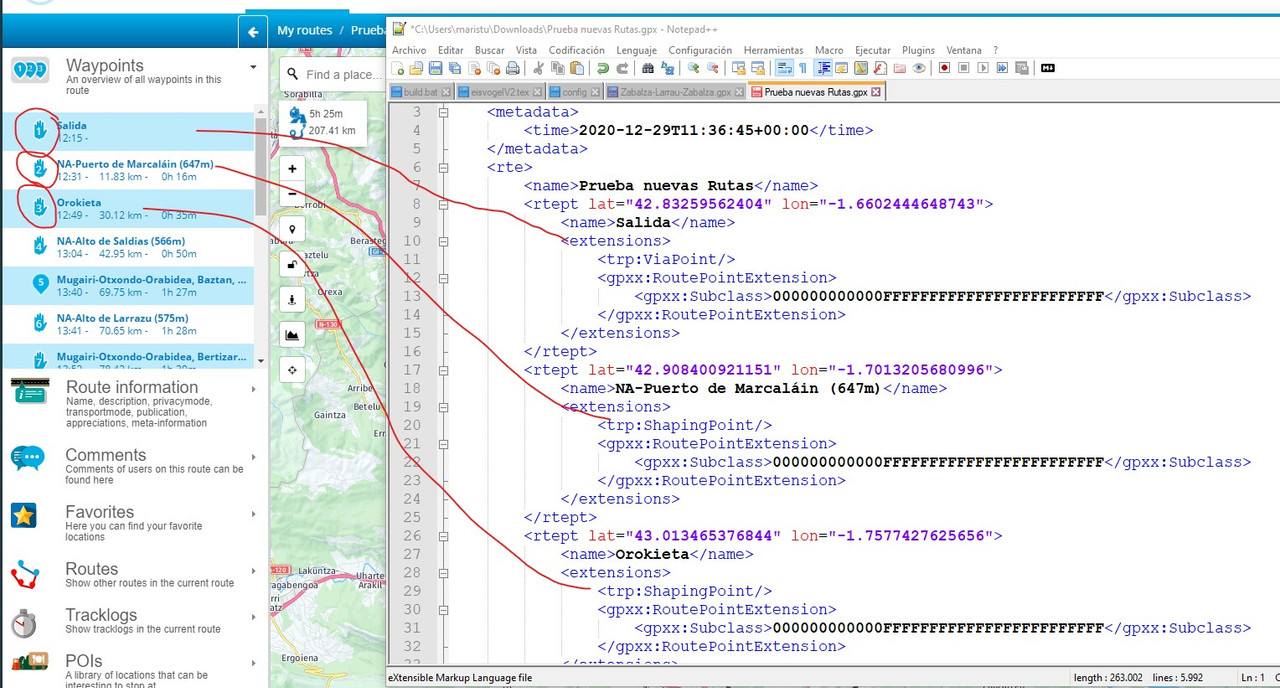

    I do not know if this is correct, but it seems it is an issue. I have created a new route. you can see here:
    https://www.myrouteapp.com/en/social/route/4107278?mode=share
    All its points are via points, but once I export to gpx Only the first and last one are via points
    Image link
    Thanks

      @Mariano-Aristu Try the GPX 1.0 Format.

        Save route as gpx1.1 on your pc

          @Reinhard-32 Thanks, but I need shaping points and via points.
          @Hans-van-de-Ven-MRA-Master It is already saved as gpx1.1 (Not the Beta)
          Now I have saved With Beta 1.1 and seems to be a bit better... I will try it

            Hi Mariano, .gpx 1.1 (Beta is only for the Garmin XT
