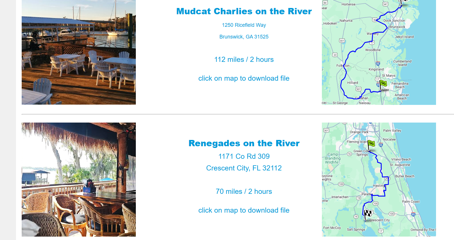

            Well, my main reason is that I am a part of a BMW riders club and on our Website we post the rides with 2 screenshots. One of the destination and the other is the Track of the Route.
            It would be so much easier for me to just bring up a Track in Route Planner directly, take a snapshot and post it to the Web.
            Another reason is to share the proposed Track with friends who are not MRA members. They can see the whole Track without being inundated with the shaping points, etc,....
            Hope that helps... Just a convenience thing. I don't think it really is a big deal to implement, is it?

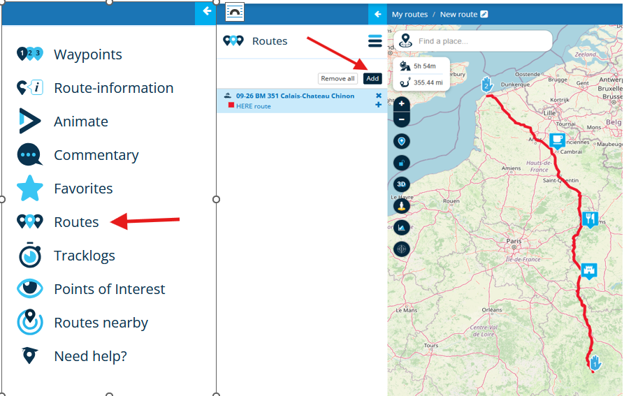

              @Lenny-O if I am reading your post correctly then I think what your after is already possible with MRA without the need for any form of syncs for tracks
              firstly I am going to assume by snapshot you mean a screenshot of the page, so just a picture of the route &
              you want this to be a clean uncluttered image of the path of the planned trip with no waypoints
              the simplest way to achieve this is to just create a new blank route
              then go to the side menu & select Routes > Add & add the route you want to screenshot
              you should be able to get a result something like this on the right
              you can even choose what colour you want the pseudo track to be & if you wanted also add in a few "Points of Interest" to make it a bit more informative 😁
