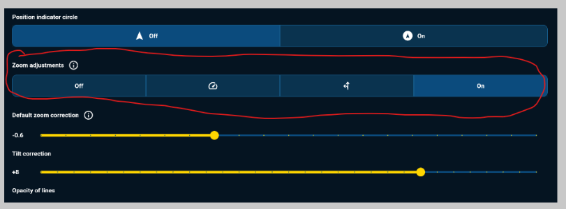

    Hello,
    On the map layer settings screen there are 4 options for zoom setting. Can someone explain these to me? I've tried all 4 settings in the Android app during navigation and they all do the same thing. I end up with a tightly zoomed in screen of my current position which is the least useful amount of information. I'd expect the instruction-based zoom setting to zoom out and show the next turn even if it's miles away instead of the next 50 meters of road. Thanks.

      @abowen I am assuming you are refering to these 4 settings
      I think the info pop up next to the heading "Zoom Adjustments" is fairly clear
      What is probably not so clear is when these functions are going to be in effect
      As far as I understand the automatic zoom functions only apply to the "dynamic" mode.
      You switch between "dynamic", "heading up" & "north up" by clicking the Compass
      The "heading up" & "north up" are both top down views & you adjust the zoom level manually with the +/- buttons
      The "dynamic" mode is a tilted/angled view, the level of tilt & zoom are controlled by the 2 settings at the bottom of the first image above

          In the screenshot above, there is <default zoom correction>. For Active 5 tablet, I currently use -0.6, which works quite well. However, you will need to experiment, as it depends on the size of the display and orientation and possibly also on the resolution.

            @abowen if your in dynamic mode then the view you see will be tilted
            you can adjust the range/zoom level you see using the "zoom correction" level
            a more negative value will let you see further ahead, a more positive value will let you see less
            the "tilt correction" also has a small effect on how far ahead you can see, it is not as big a factor as the "zoom correction"
            a more negative tilt will be more like the the top down birdseye view, a more positive tilt will give a longer more elongated view as if from the top of a building rather than an airplane

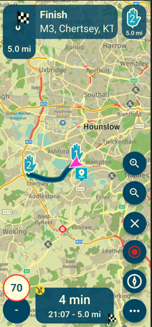

                  @abowen if your in dynamic mode & set "zoom correction" to negative two, then that is as far out as the auto zoom will go
                  on my phone which is quite a large long screen, that gives me about 15 miles, sunbury-on-thames to bagshot (M3 jct 1 - jct 3) which is way more than I need
                  15 miles is about 15 minutes ahead & i don't need to plan that far enough in advance
                  Like @Rainer-Treichel I normally use a zoom correction setting of -0.6 that shows me about five miles ahead which is more than adequate
                  "the app won't zoom out far enough" how far are you expecting!?

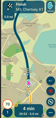

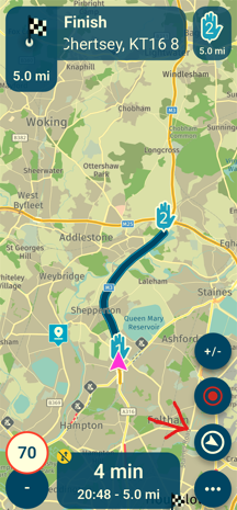

                  the compass icon tells you what mode your in,
                  the red arrow in the picture above shows a triangle symbol within a circle - this is dynamic mode & the triangle is pointing north in this case
                  your position/location icon wil be to the bottom third of your screen, in my case this is the pink triangle/arrow
                  in "top down heading up" mode your position/location icon wil be to the bottom third of your screen like this & your position/location icon will always point to the top of your screen
                  the compass needle will always be pointing to the north/south, the needles angle/orientation will vary depending on your heading, the needles angle/orientation will vary so it always points to the north/south
                  in "top down north up" mode your position/location icon wil be to the in the centre of your screen & your position/location icon will rotate as your heading changes
                  the compass needle will always be pointing to the top of your screen, north is up & up is the top of the screen
                  as far as I am aware auto zoom should definitely not be functioning in the "top down heading up" mode
                  in this mode according to the documentation the zoom should only be set by the magnification keys + & -
                  no auto zooming should be occuring & the map should stay at the fixed zoom level you have chosen with the + & - keys
                  If things are zooming when your in "top down heading up" mode then something definitely seems wrong
