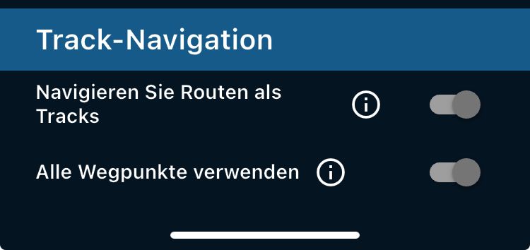

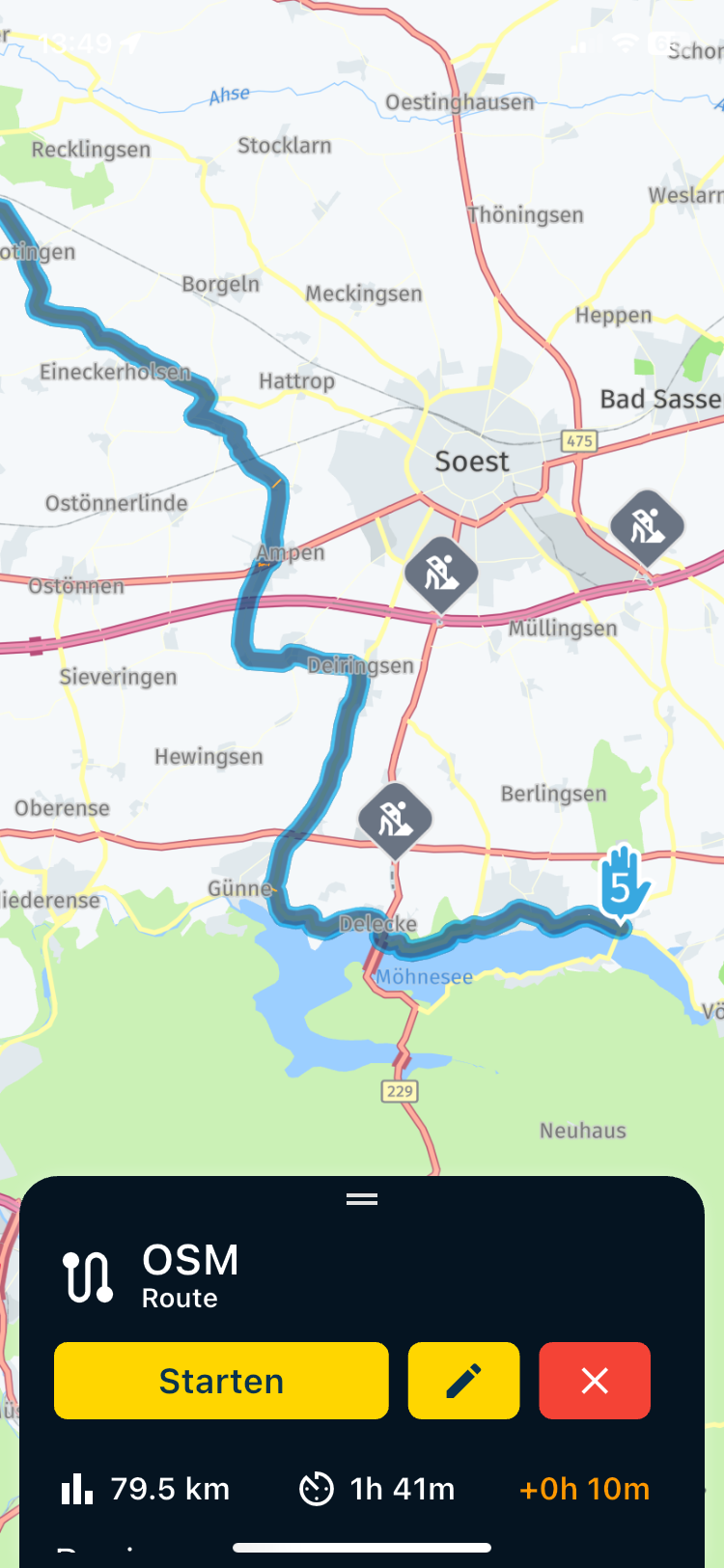

      Planning as a route in OSM map and displaying it as an OSM engine, goes well once you recognize how to go. 😉✅ see settings ... "Navigate route as track" fits from my point of view.
      Als Route in OSM Karte planen und als OSM Engine anzeigen lassen, geht gut wenn man es einmal erkennt wie gehen kann. 😉✅ siehe Einstellungen … „Route als Track navigieren“ passt aus meiner Sicht.

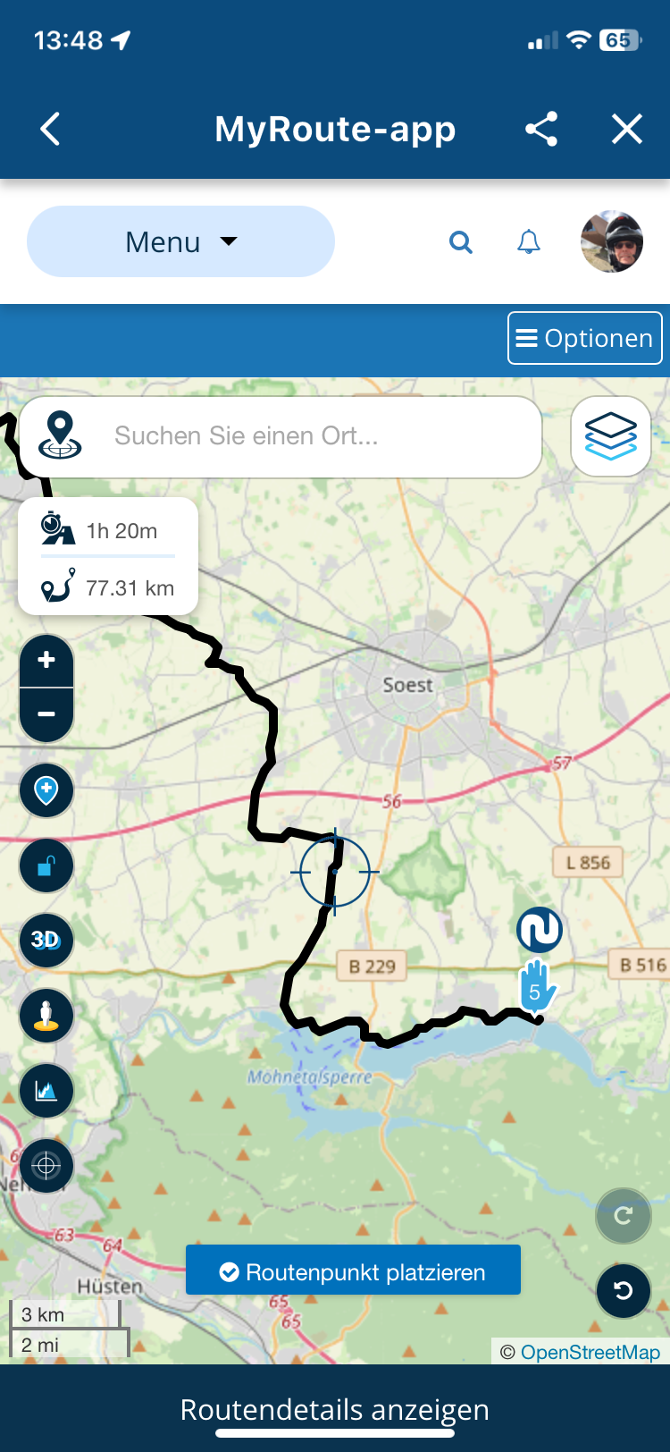

        What you could do is create the curry route, store it.
        Open a new route, using Here en display the curry route. Then you can add a lot of shapingpoints in the Here route to duplicaten the curve one

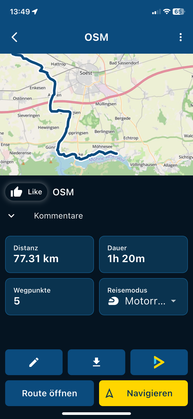

          In case you open a route, that was created AND stored with OSM-Routing active, in Navigation the track Navigation will be advised or automatically switched ON.
          RT
