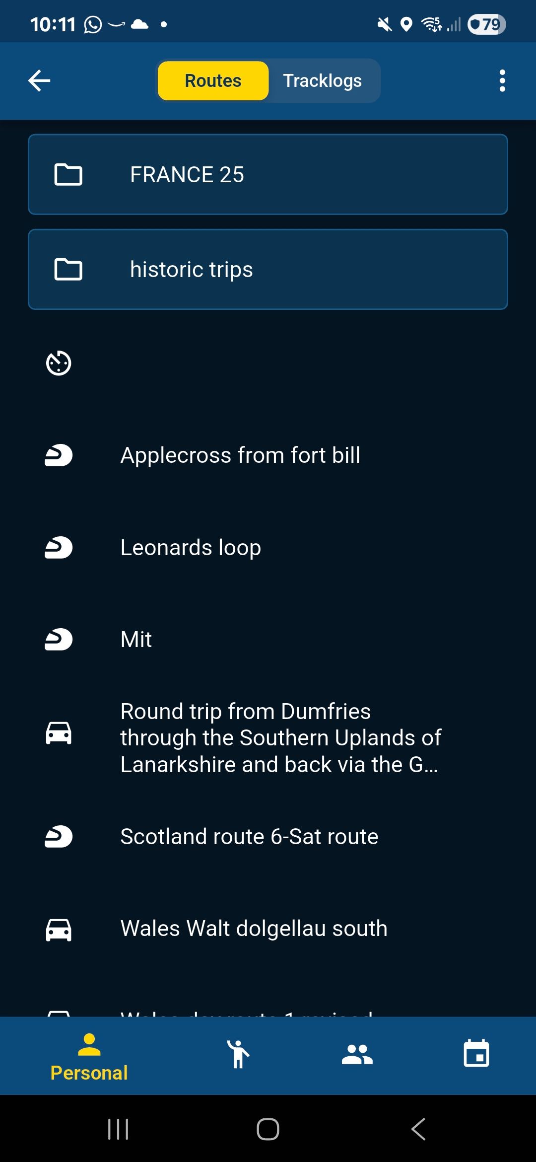

      @John-newman can you see the route folders on your phone
      • John newman
        John newman
        John newman
        Yes no problem on my phone
