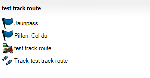

    Dag allen,
    Ik heb een route gemaakt in de HERE kaart.
    Deze geexporteerd als een GPX 1.1 (route, track, POI)
    Als ik deze route open in DMD2 (ja ja ik weet het..) dan ziet hij 2 tracks.
    Alle andere dagtrips (behorend bij de hele route) geeft hij in DMD2 netjes een track EN een route. Rara....
    Wie kan mij uitleggen hoe dat komt?

          Hi @Arjan-de-Vries when I save your route as gpx 1.1, the file it all seems perfectly normal,
          inspecting the gpx file it contains the usual waypoint details, route points & track points
          Importing into Basecamp & it shows correctly as only the 2 POI a single route & a single track
          to me it would appear to be a DMD import issue but I don't have a DMD to test with sorry
          you could try splitting the route into 2 halves in MRA & see if each of the 2 halves also produce 2 tracks or if the issue is with a particular part of the path

            @Arjan-de-Vries said in Route en track:
            When I open this route in DMD2 (yes, I know...), it shows two tracks.
            When importing a GPX into DMD2, all routes containing more than 100 routepoints are considered as tracks. That's why you get two tracks.
            Deleting three points will result in a track and route as expected after importing into DMD2.

                  Well, the 100 or less did the trick.
                  I want to have DMD2 as a backup for MRA. I use MRA on my t865x tablet.
                  I like the maps view of DMD better though.
