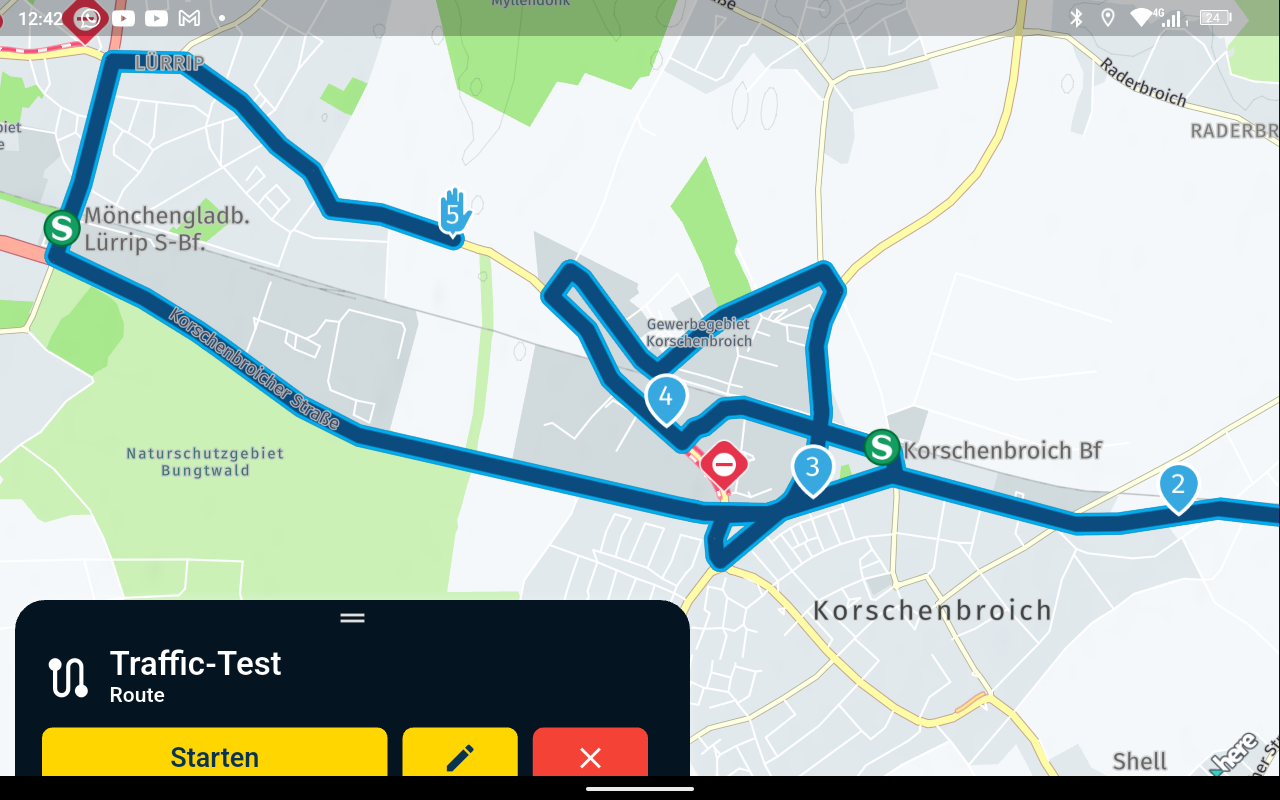

    Hi, we just discuss in another post (in German) the influence of traffic aware calculation.
    I made a sample with a waypoint inside a closed route. The route calculation is a bit strange and tries to get around the closed street. (At WP 4 the street is only closed in the north/west direction)
    But when I disable all traffic aware functions in the setting, the route should be calculated strait from WP 3 to4 to 5, right?
    Do I understand something wrong?

      IMHO, there are two different aspects:
      The picture from @Jörgen is about a closed route; this information comes from HERE data.
      ‘Traffic aware route calculation’ refers to live traffic data - even if you switch off this option, route closures (from HERE) are still taken into account.
        No, road closures are not traffic related.
        This will always be avoided but given the waypoint exactly on a closure, this is the result 🙂
