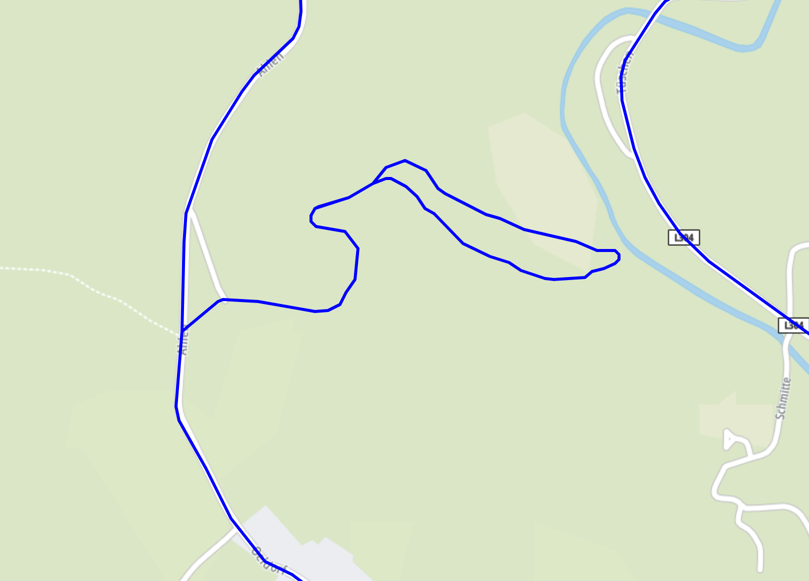

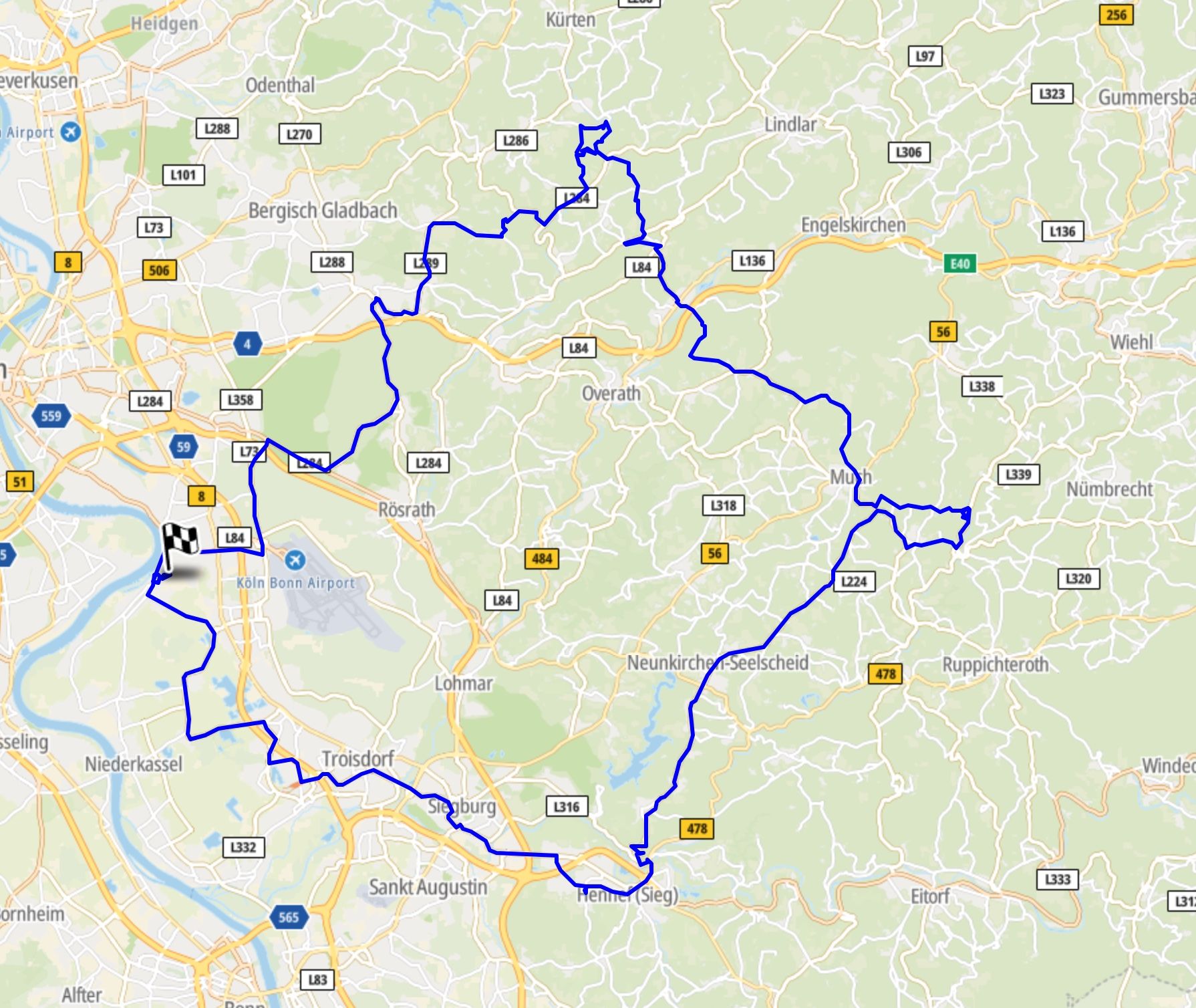

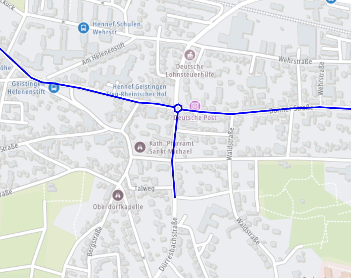

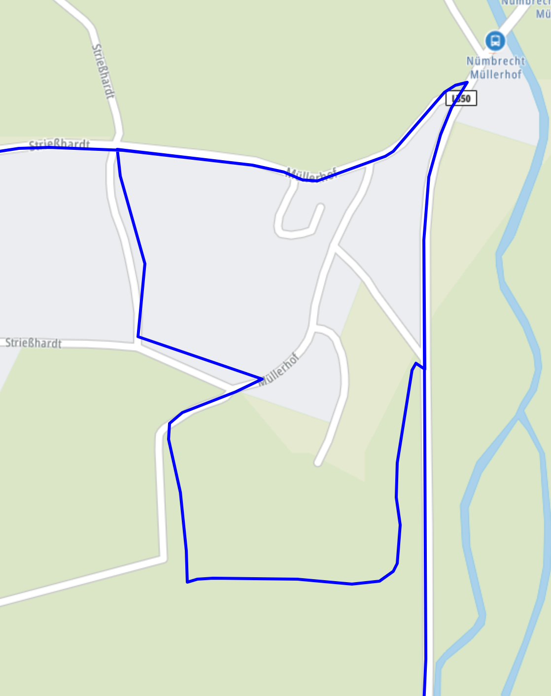

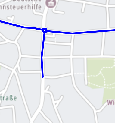

    Hello everyone,
    Since using MRA I have a problem with the route creation of MRA. Whether routing between two points or creating a round trip, there are always places where pointless loops or driveways are created with the need to turn. The route always looks great in the overview, but then the nonsense comes to light while driving. I'll post some pictures to prove this. It really happens every time. Something like this could be checked before a route is issued, couldn't it? The context is missing. And during the motorcycle ride, there is usually no return to the actual route. Can you manage that? I'd really (!) hate to have to switch to Kurviger, it works perfectly there (as far as these errors are concerned).

                    What I have already learned, however, is that when planning my own route (no generated circular route) I can no longer work with 2 waypoints and then place others in the “green” so that I am routed to interesting areas. Into the green ok, but then move the point to the road, because otherwise (in my attempts 50:50) nonsensical deviations in the direction of the waypoint occur while the actual route continues.

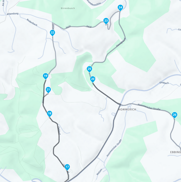

                      I have downloaded the route and looking at the error shown in your second picture above the waypoints are all over the place. Not surprised that the route is odd. However, don't know if the waypoints i am seeing correspond to your original plan because it is taken from the track. I don't know how this process works

                        this is a circular route generated by MRA, I have not set any points (especially not so many in a small area).
                        It may be due to the routine for generating circular routes in general. I was just trying this out, it is not my primary intention to use circular routes.
