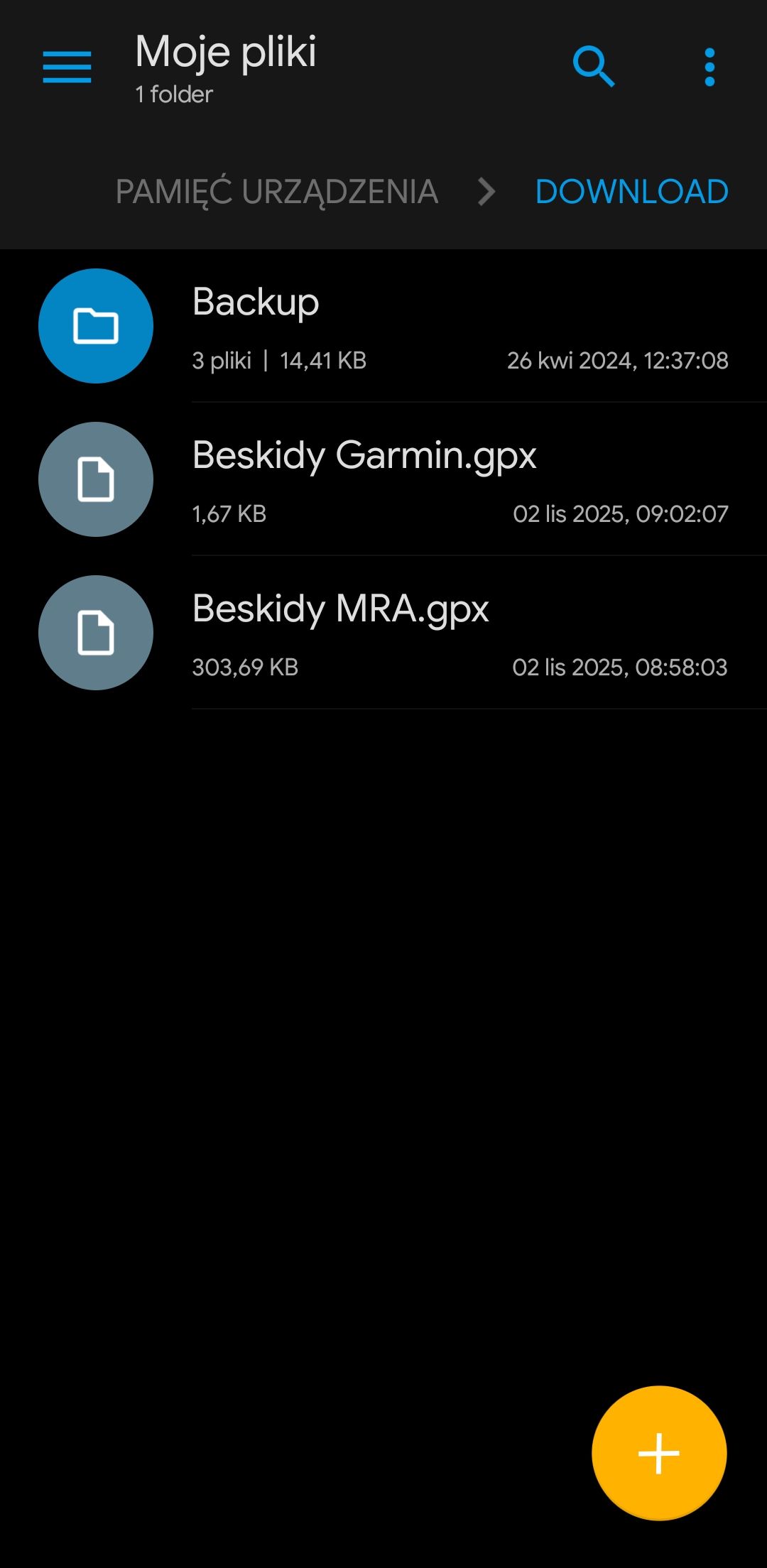

        Yeah. It is very complicated to export GPX MRA --> Sygic.
        Also tried Tread and it work ok.
        No idea what is wrong with MRA GPX File.
        Planing route in MRA. Exporting GPX to Tread. Then exporting GPX to Sygic.
        Annoying 😕
        Just check the sizes.
        Same track with waypoints.
