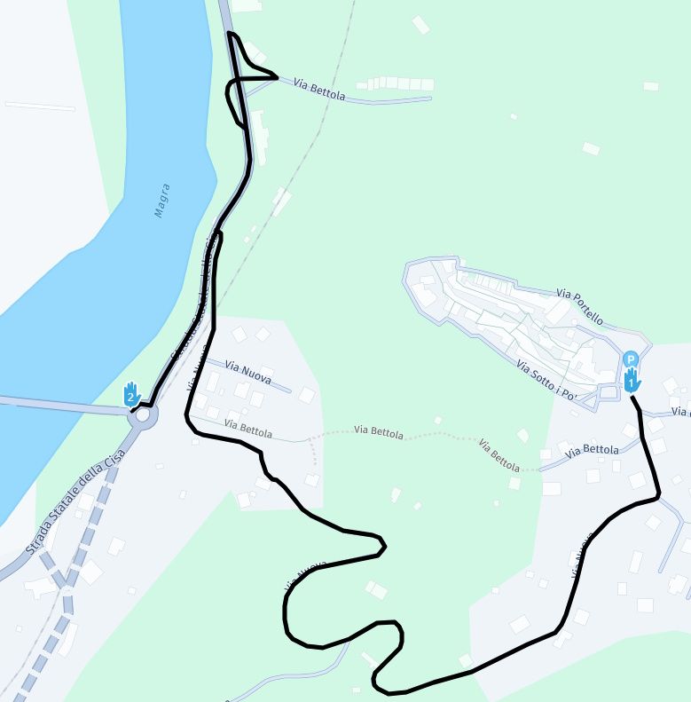

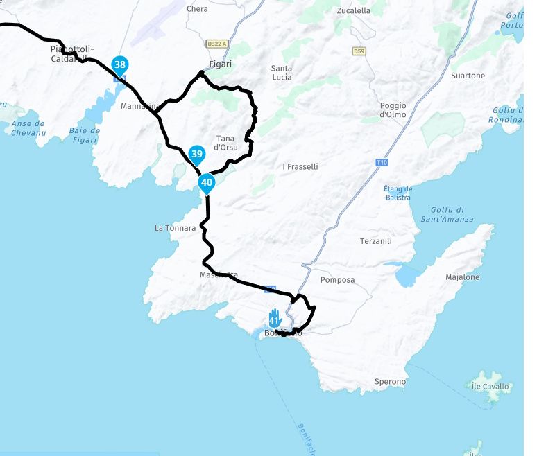

    I am planning a trip to corsica and sardinia in May, but on the way to Bonifacio I get this problem using Here:

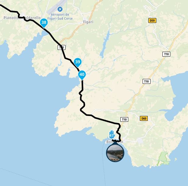

    with tomtom instead the route is correct:

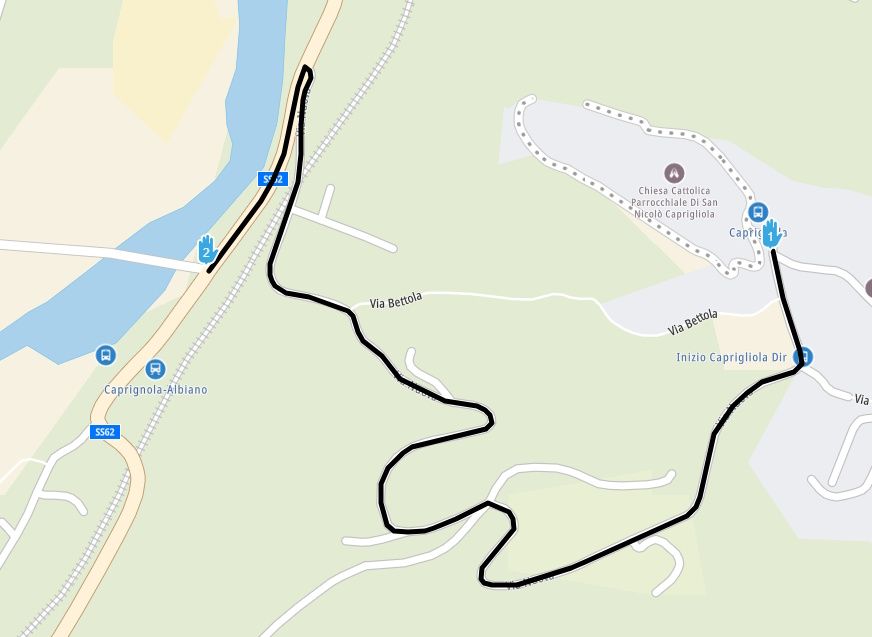

    the same kind of problem occurs when I select my home as the start, this is what comes up:
    when the correct route would be this:
    When I navigate with the bike, which route will I see on the screen (Here or Tomtom) ?, because as long as I'm in areas I know I have no problem following the right route, but when I'm in areas I don't know I will definitely have problems.
    The public route to Corsica is this one:
    [link text]https://www.myrouteapp.com/route/open/10534286/here#41.412608176283975;9.047927856445314;12/ (link url)

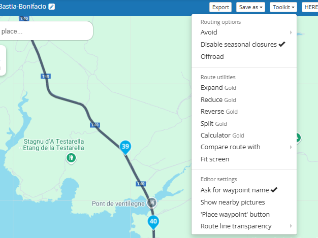

      @ginogino click the "Disable seasonal closures" in the Toolkit and it plots as you intend.

        On the corsica route, by disabling the seasonal closures the thing works, but will it also work during navigation ?, the thing however does not work on the route to my house and I would like to point out that the road that is recommended does not exist, to travel it I would have to pass through the middle of the river, this is a piece of a route from almost my house to the first roundabout:
        link test route
