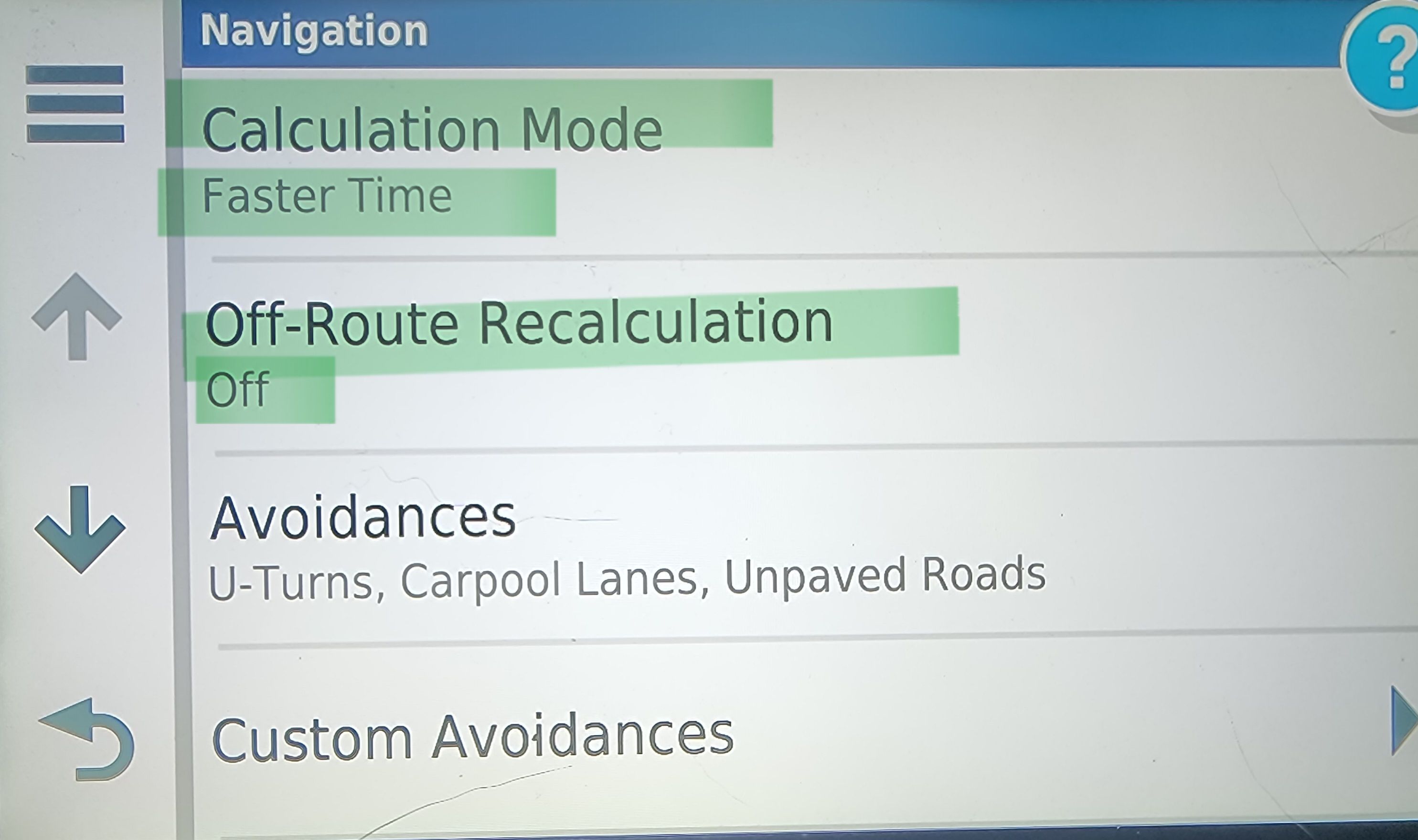

                    Greenhamundefined Offline
                    Greenham
                    @Marinus-van-Deudekom
                    First thank you all who have tried to help me. It's slowly making sense thanks to you guys. I now understand the difference between planning and overlay maps.
                    I now only use HERE, for planning then compare my work/route with Tom Tom and OSM.
                    What is still unclear is exporting my route via 1.2gpx and I decide to skip a waypoint. All the following shaping points seem to be ignored and zumo defaults to the default routing method within the GPS (fastest, shortest etc) using the few waypoints that still haven't been passed/used.
                    Until I understand this behavior I'm lost.
                    Again I have recalculation off
                    ![alt text](image url20250105_075332.jpg )
                    The key seems to be between 1.1gpx vs 1.2gpx
                    Should I just be expecting via 1.1 instead of 1.2gpx which is what I have always used

                          @Greenham From John Heaths excellent navigating with a Zumo Guide.
                          " MyRouteApp.
                          Very popular and provides a very good
                          solution. Possible issues for the Zūmo user :
                          Gpx v1.1
                          Track, Via Points and Shaping Points. No
                          Favourites. Zūmo has to calculate route - it
                          may end up being very different.
                          GPX v1.2
                          Track and Via Points. The plot of the route
                          is also transferred so the roads travelled are
                          identical to those plotted on the MRA map.
                          However, if the route is recalculated, it has
                          only the Via Points to work with. None of
                          the shaping points are transferred.
                          If you use this format, it is important not to
                          do anything that would make the Zūmo
                          recalculate the route.
                          Turn off Auto-Recalculate !
                          No Favourites are transferred to the Zūmo.
                          As stated above I use GPX1.1 and use lots of shaping points and display the track to ensure that my intended route and route as calculated by the XT match. The @ Martin-Wilcke method will also work well as long as you don't use recalculate to navigate back to the route.
                          Here is an example of a route (magenta line) and track (yellow line) I want the route to be the same as the track and travel along the B128 but because of the spacing of the shaping points and via points the Zumo XT "Faster Time" algorithm routes down the A28 and up the B45 which adds miles and time to the route. You can fix this in three ways
                          1. Tap the map on the unit (as shown) to add additional shaping ponts to match the track
                          2. Make sure as stated above that there is a waypoint on the B128 as you plan the route
                          3. Use GPX1.2 and make sure that you don't recalculate the route when you are on it by switching off automatic recalculation.
                          As with all things its a bit of a learning curve and you are doing the right thing by testing and using the unit before you are on a live tour. That is very important.
                          Also when planning your routes put the start some way up the road from where you are actually starting as this ensures that the unit passes through the start point and does not try to take you back to the start as you have missed passing through it by a few metres.

                                martin-phogel.deundefined Offline
                                @Greenham
                                When using GPX 1.2, avoiding recalculation is key as a recalc will affect not just the section to the next VIA but the complete route!
                                Unfortunately, skipping a VIA will force a recalculation. Most of the time, you will pass all VIAs as planned. If you need to skip a VIA for any reason, the only way I know (on an XT) is as mentioned above:
                                Stop navigating the current route, find your way back (that's where having the track displayed additional to the route can help), and if you get back on track (important!), start navigating your original route again - it will start from your current position.
                                Avoiding recalculation is the significant downside of using GPX 1.2. If this doesn't match your preferences, GPX 1.1 is probably a better choice.

                                      Hans van de Ven MR.MRAundefined Offline
                                      @Greenham said in STILL having issues w/ my Zumo XT not following the route:
                                      Thas is because: the gpx 1.2, which is a route-track with via points. So no shaping points in the gpx file

                                        Marinus van Deudekomundefined Offline
                                        @Greenham of you're using a 1.2 and you want to skip a viapoint (there are no shaping points in a 1.2) navigate to the displayed track after the skipped viapoint and then press skip waypoint om your XT. It will then keep on the route
                                        Have you found out how to display the track under the route?

                                          @Marinus-van-Deudekom said in STILL having issues w/ my Zumo XT not following the route:
                                          I don't know what you mean with "keep on the route", but skipping a VIA will force a recalculation, which may lead to a different result.
