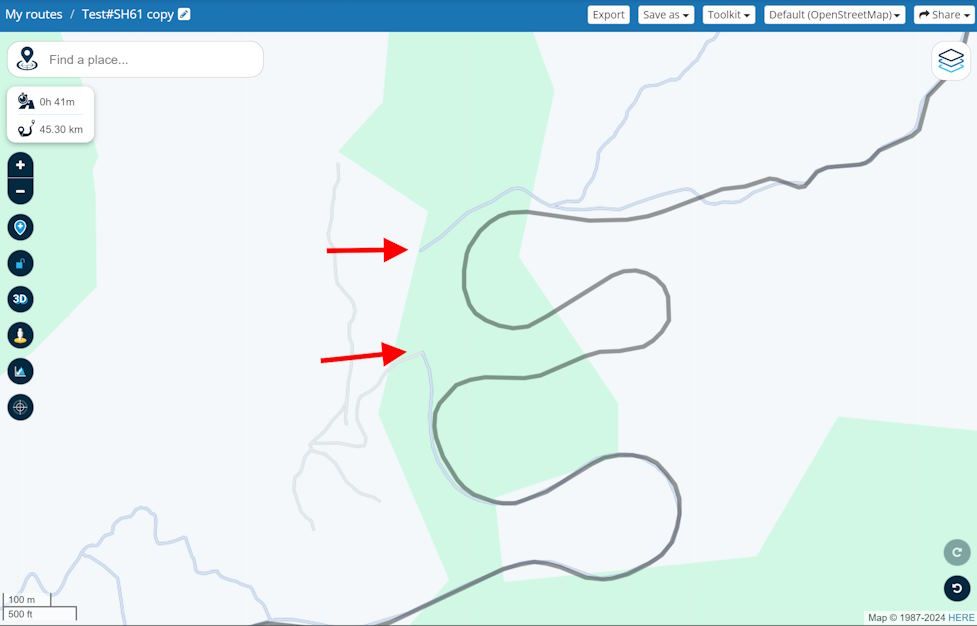

      Here is another example to point out that this issue is not related to ferries only.
      This part of SH61 in Albania is recognised by OSM but not by HERE:
      https://www.myrouteapp.com/en/social/route/10331015?mode=share
      When opening for navigation, the app reported an identified mismatch but poofs to navigate it exactly as planned when selecting "track". But it does not. The navigated route is neither OSM nor HERE.
      I want to understand the concept of navigating routes as tracks, as it is crucial for my planning and navigation. I prefer planning with OSM as it often fits my needs better than HERE, and I have always searched for a way to navigate routes planned with OSM. Navigating a route as a track could be the perfect solution if it works as expected.
      Is there an idea of what's going wrong here?
      And, by the way, what does "you will lose all waypoint information" mean? I expected to keep the waypoint information, at least for VIAs.

          I know. I toggled it off to get the warning in the app and used "track" explicitly, which should lead to the same result as I chose "navigate route as tracks" as a general setting.
          In my example, the route shown in blue does not result from an HERE routing. It looks like the app tries to route with HERE, can't resolve it and uses "straight lines" instead. But I'm just guessing.
            It looks like this gap is "routed" with a direct link.
