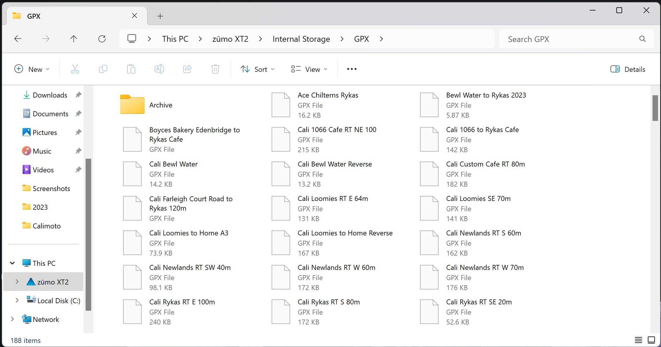

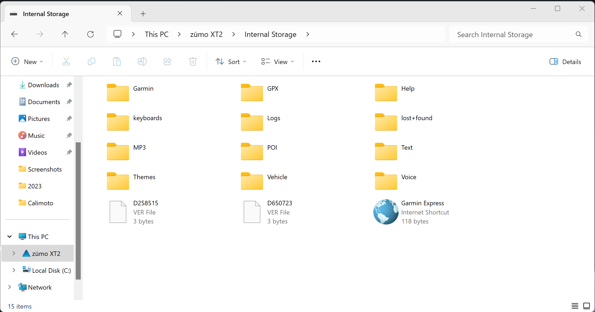

                                  Lynchy67
                                  @truckpilot
                                  In Google type Garmin Express Download.
                                  Start Garmin Express.
                                  Then Plug the XT/XT2 into your Laptop.
                                  It will take a few minutes for the XT/XT2 to Sync.
                                  You will hear a beep when the XT/XT2 is synced.
                                  Go to the GPX Folder.
                                  Paste your GPX Files into the GPX Folder.
                                  Disconnect the XT/XT2 and power it up. It will ask you to select the files you wish to import.
                                  Job Done.

                                    @Lynchy67 strange because i do not need garmin express to connect my xt to windows pc. i only have to use it to update mijn garmin's.
                                    i just connect xt wired to pc and i can copy gpx.

                                        @TomOnTour
                                        On windows pc normally no other program needed.
                                        When i connect my XT2,it shows up in the file manager/explorer ( verkenner in dutch).
