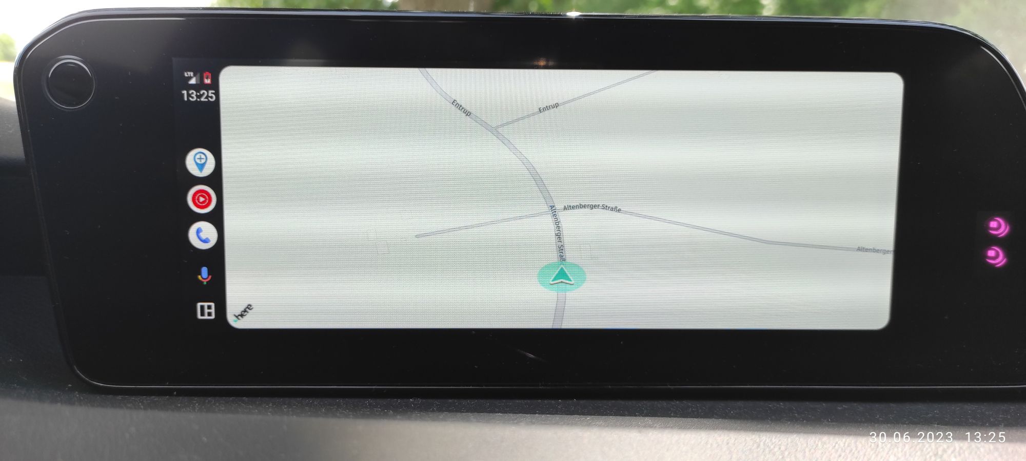

                              Yesterday's update to version 4.0.2 didn't solve the problems either. Still no menu on the map and "click" on the MyRoute-app icon only toggles between full screen and split screen.
                              Loading the last route does not work either.😢
                              I have now downloaded the app to my wife's smartphone (Samsung Galaxy), but apart from a few minor things (MyRoute-app does not start automatically and no indication of missing authorizations), the app does not work with my vehicle.
                              Loading the last route does not work...
                              My car´s display still looks like that...
                              Loading a planned route on the smartphone.....
                              looks on my car´s display like that.....
                              And when I start the navigation on the smartphone.....
                              these are the only things displayed an the car´s screen. 😞
