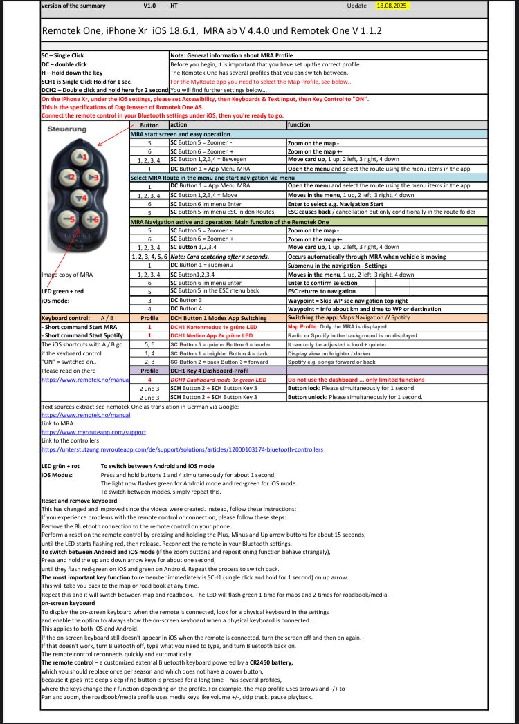

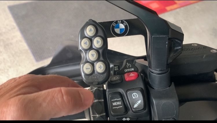

                      Hey to relax it,
                      This is a long-term good solution without cable clutter ...
                      The Remotek One replaces the WW on a BMW R1250GS and can simply do even more.
                      http://www.remotek.no/
                      Addition of the BT keyboard - Remotek One
                      Funktionen:
