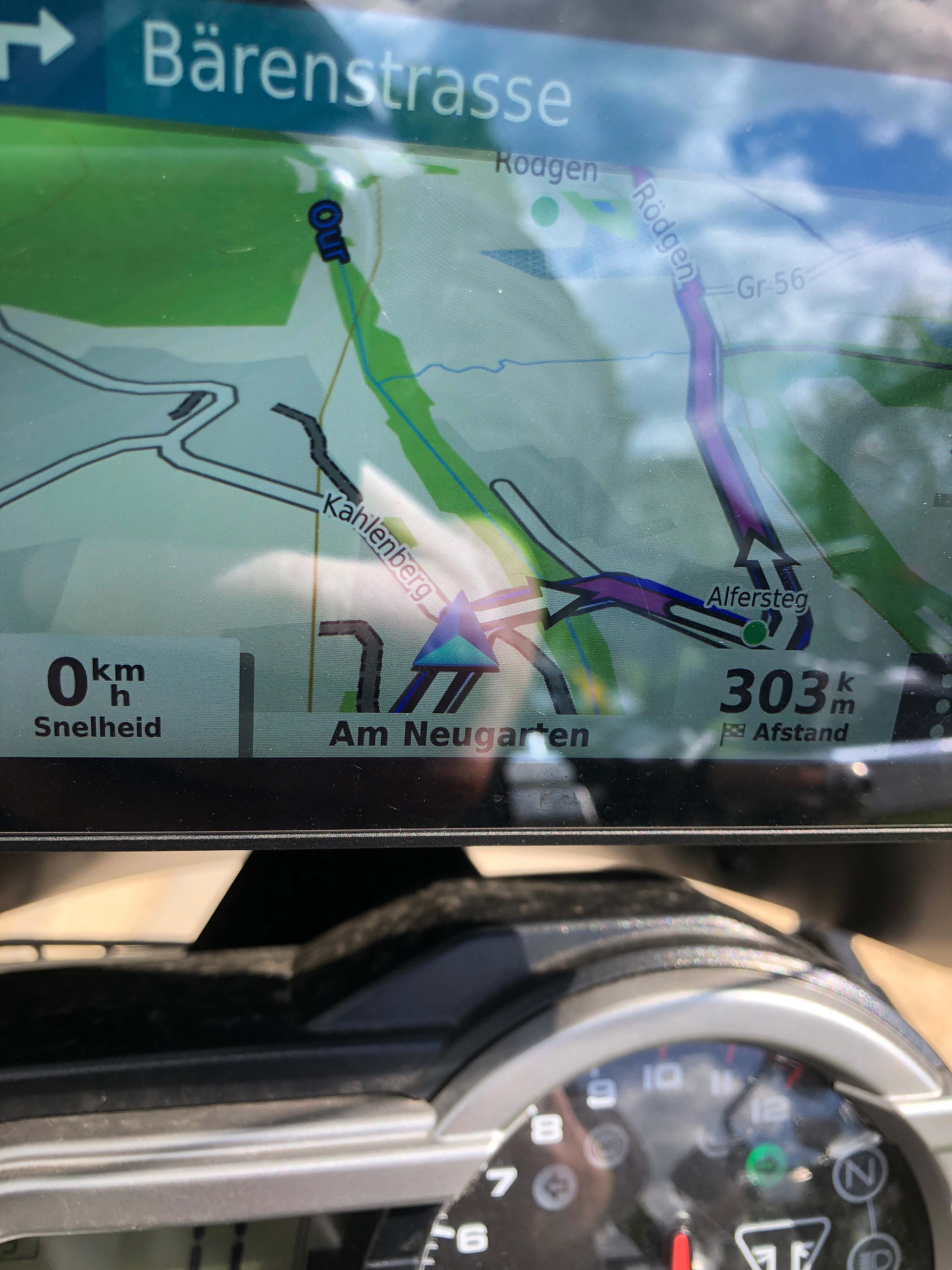

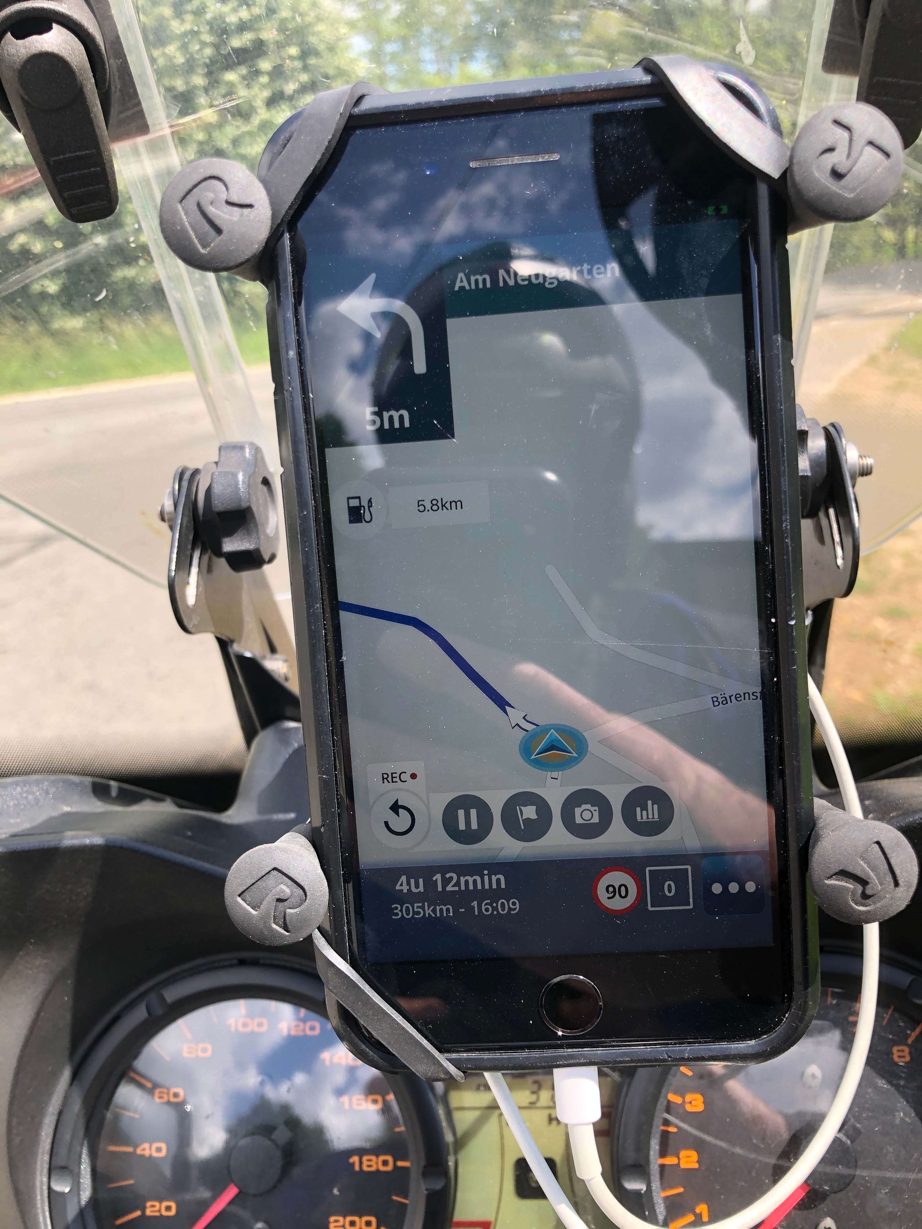

            we did not see alternative roads but what we often did see was that the Zumo xt followed the route and the navigation app decided to go the other way. See pics.!IMG_4837.jpg IMG_4835.jpg

              @arjan-de-vries Thanks for the screenshot. The map used in the XT is a different version to the map that MRA Navigation uses. I suspect that adding a few more route points would solve the problem. Can you share your route here please then I or others can give you advice for future route planning.
