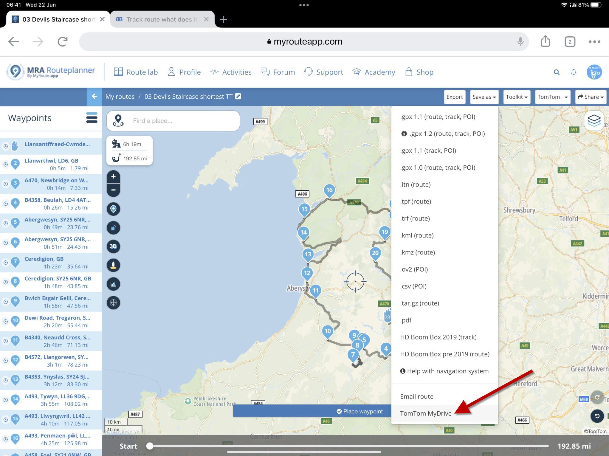

                For anyone that is only interested in using Tracks on a TomTom Rider you can use the functionality provided by MRA in the “Save As” Menu, the very last option “TomTom MyDrive”, will only transfer the Track to TomTom MyDrive and the TomTom Rider it will not transfer the Route.
                You will see a pop up that requires you to enter your TomTom MyDrive email and Password.
