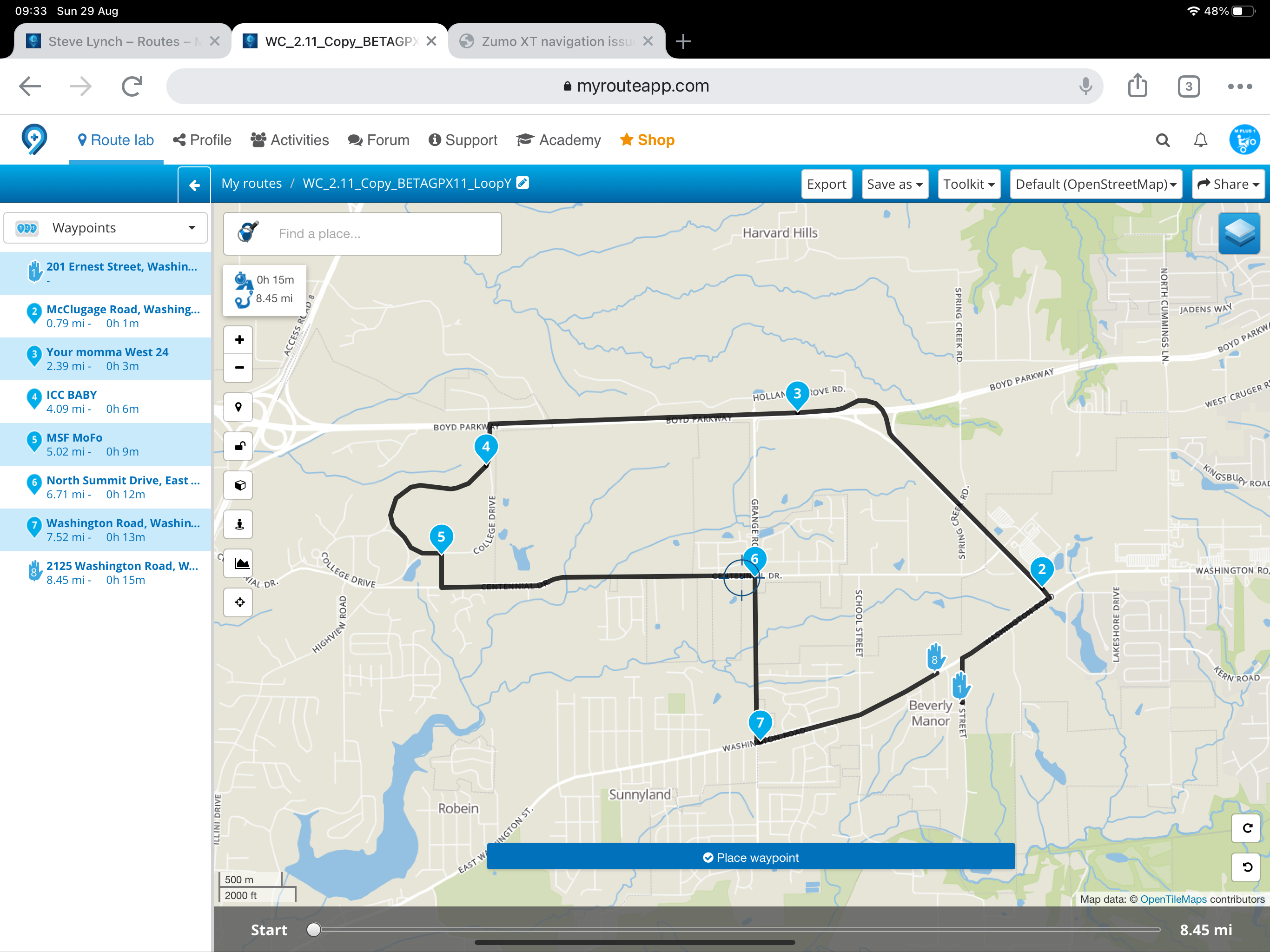

              @Chris-Smith
              You are effectively starting your Route from “Home” which is also the final Destination Via Point as it shows in your video..
              The obvious solution would be to amend waypoints 1 and 8 as below.
              I’m not going to offer a cause for your issue however as I am still working out the niggles on the XT myself.
              One other thing to mention, are you using the Here Map when creating your routes in MRA?

              • Chris Smithundefined Offline
                Chris Smith
                That's not the final map. That one didn't work, so I moved the first via point along, and moved # to my actual house. It had issues also due to me not precisely placing the first via point and also me NOT using the HERE maps. So overall, a cluster.
                https://www.youtube.com/watch?v=f-refhmPtaQ
                After some analysis from others on ADVRider, I came up with the following lessons learned and applied them, then the route worked fine.
                1. Use the HERE maps when exporting.
                2. Be precise when placing via points
                3. Put my first via point in a loop route far from home/motel on a loop route.
                Here is that thread. I have learned a LOT, thanks to input from many such as yourself, so thanks to all that contributed.
                https://advrider.com/f/threads/zumo-xt-vs-myrouteapp-circular-route-goes-straight-to-end.1516701/
                If you'd like to add to my lessons learned list, I'm all ears.
