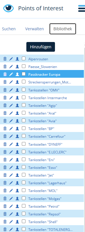

        @Alfredo-3 You can also create a list of specific petrol stations and choose to display only those.

          @peter-zehentreiter Thank for your reply. I'll try to be more specific. I create my personal list (like your "tankestelle OMV". It asks me to select an icon. If I seIect the Gas Station Icon, I will activate all the Gas Stations, and not just those in the list.

            if you make your private list with for example only the SHELL stations and import them in MRA again.
            Then go your libary and select the imported POI list, and with the pencil you can change (all) of the POI in a different marker. downside is that the markers are very limited and only blue.

              @BertM I downloaded a DKV gas station file, filtered it by operator, converted it to the appropriate format, and then imported it into my POI library.
