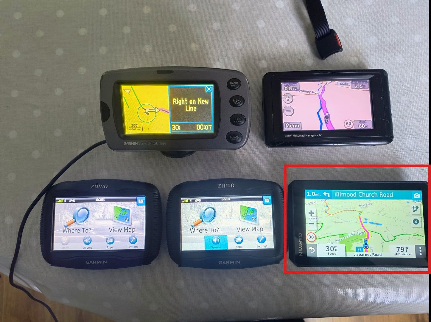

                        What you describe is not a MRA problem. I've used Garmin devices since 2004 I still have all of them and they all still work so no issues with the hardware their software now sucks
                        For me the my XT was problematical until I divorced it from Garmin Explore. I use it on an Africa Twin adventure sports for proximity alerted POI's and tracks only. The little Zumo 340 and 390 are used on my old R1150GS and are great little units. The old Nav iv and Streetpilot 2610 i use to test compatibility with garminised open street maps.
