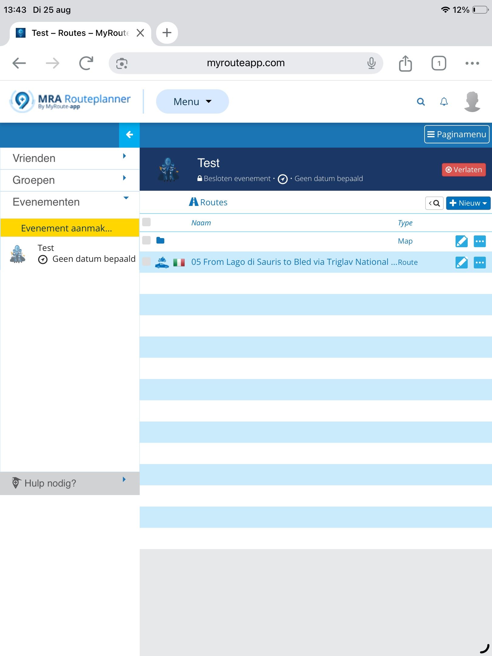

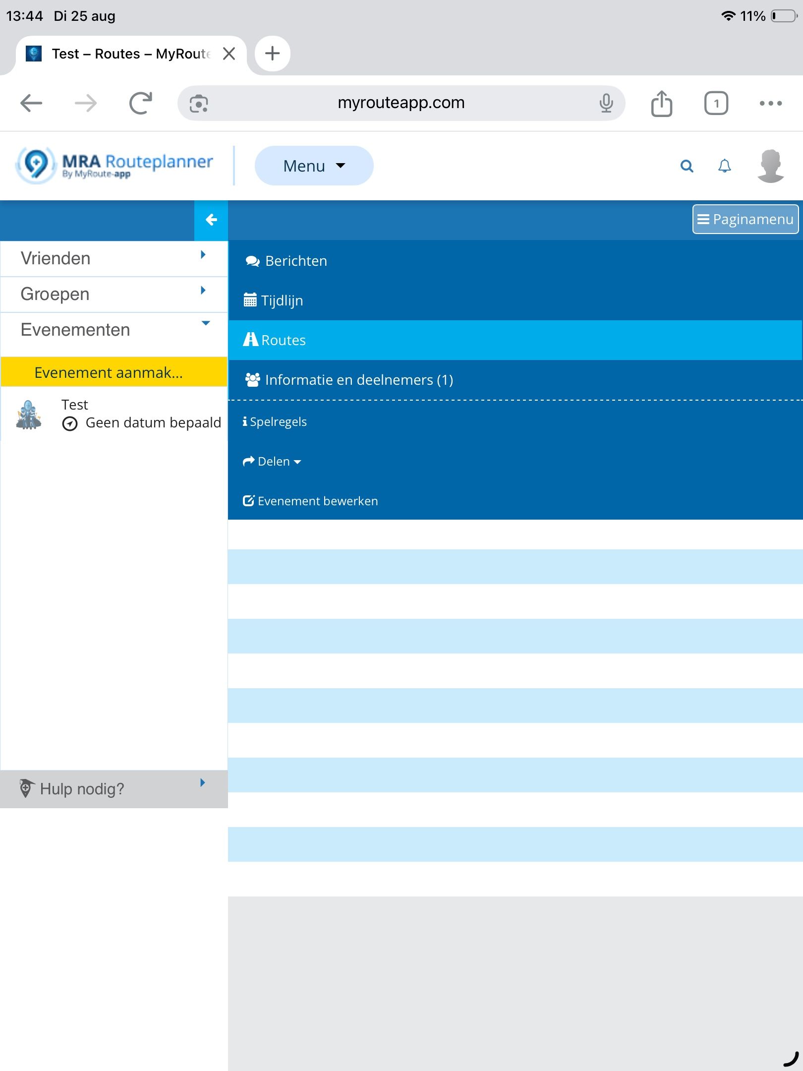

          • BertM
            Make a (closed) event and add your friends.
            There you can share items in the group or link routes
