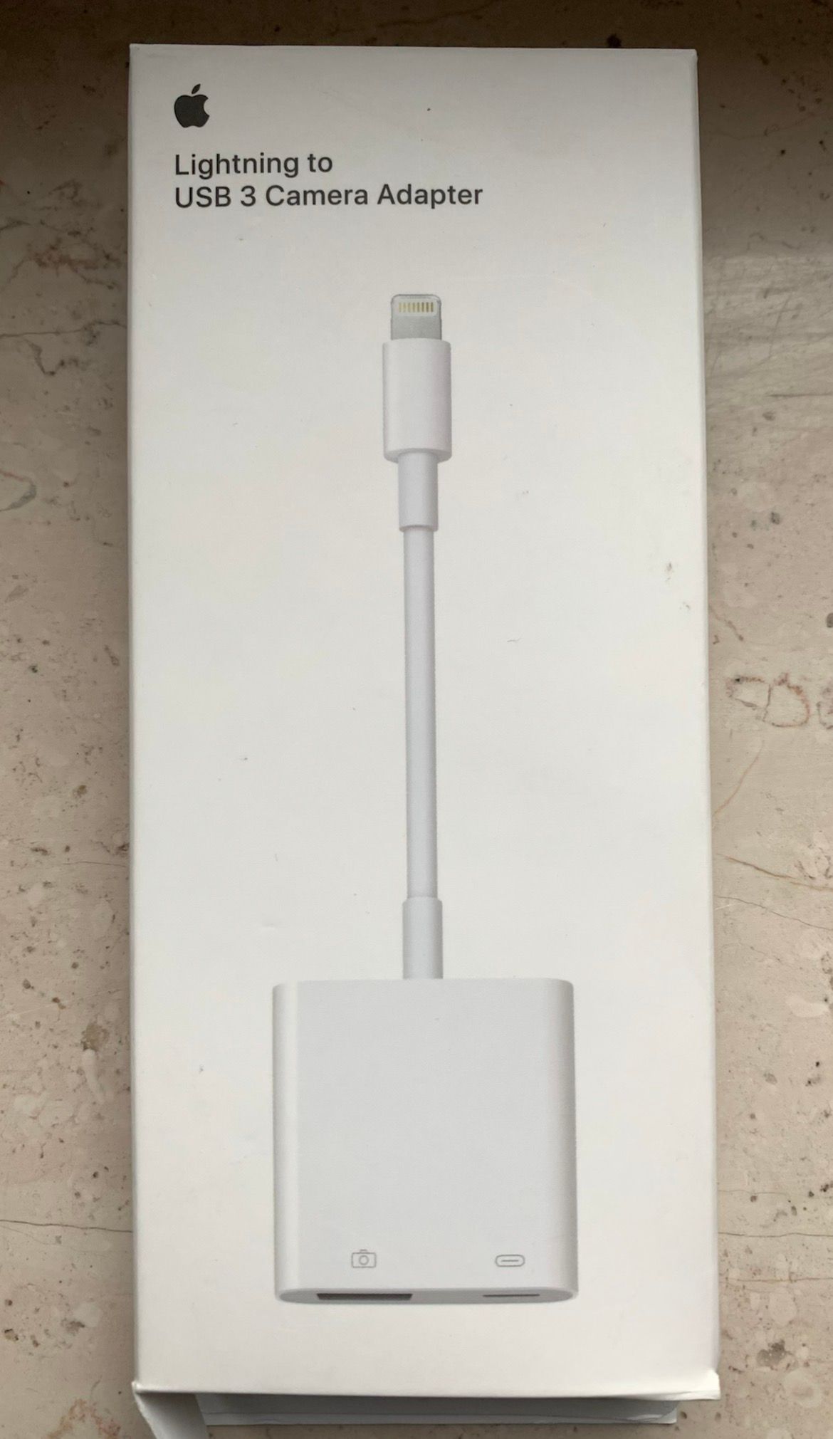

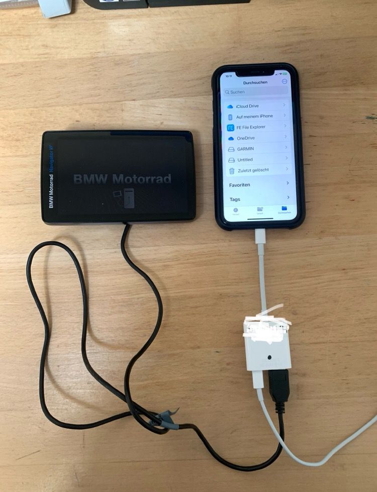

        But this is possible, whether from the iPad or mobile phone with the camera adapter see photo

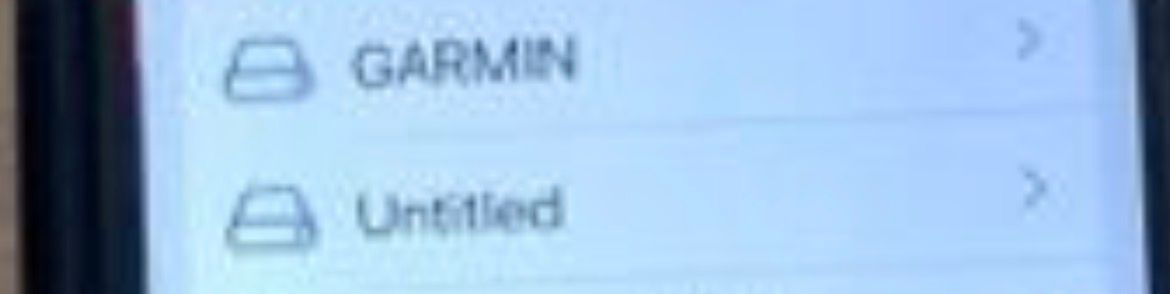

          These are the two directories on the Garmin that are displayed on the mobile phone, see photo ...
          • Garmin is the memory on the device internal
          • the other is the SD card if available
          Important:
          When you have saved the routes from the MyRouteApp in the iCloud, just slide them over to the Gramin directory... as usual on the PC.
          That's how I used to do it...
