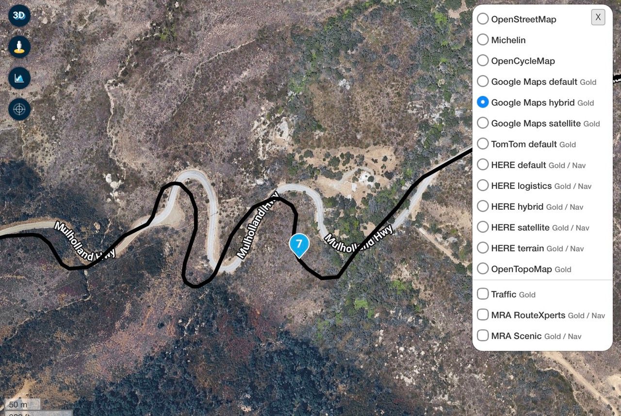

          Update: I went back out today to see if I could repeat the behavior related to waypoint#7. I fired up the route and followed it without deviation. Just like I did the first time around.
          And I got the exact same result. It's repeatable! MRA/HERE thought I had missed waypoint #7 (I didn't) and I was directed to turn around at Calamigos Rd to return.
          In preparation for this expected outcome, I copied the route and moved #7 further up the road (closer to #8) to see if it would change HERE calculation behavior.

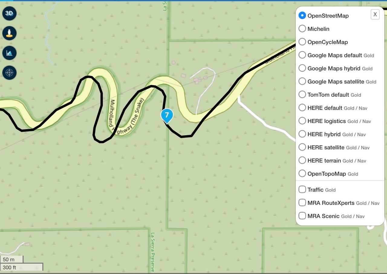

            The cause is the discrepancy between the road layout on the HERE map and the actual situation. There is an error in the road layout on the map. See screenshot. If you switch on the OSM or Google Maps overlay, you can see this. The waypoint #7 is in the middle of nowhere and cannot be reached by car or motorcycle.

              @reinhard-32 Yes, I suspected it had something to do with the placement of waypoint #7 in the curvy/technical section of Mulholland Highway. I didn't take the rigorous investigative step you presented to compare against the other map overlays or use the Compare option in Toolkit. It confirms why moving #7 to a section where HERE is in sync with the actual road fixes the problem. Thanks.
              It's ironic that all the maps except HERE are in sync with the actual road layout. Should I be surprised?
              I'm not an expert in the internal workings of MRA or HERE. But intuitively, it seems that if HERE in Routeplanner thinks the placement of #7 is OK, that HERE at calculation time in the App would also be OK with the placement. That's obviously not the case. My belief as a user is that I should not have to be concerned with inner workings at this level, but....
              Moving forward, one option (during route development) is to always compare to the other overlays and never place a HERE waypoint where there is a map discrepancy. That could work in the majority of cases, but what if it doesn't? There may be situations where a waypoint is needed, but I don't have the option of simply relocating it further up the road. Since I have to use HERE for any route executed within the App, what then?

                                @John-S-Parry in the "Toolkit" menu the function "Compare route with" is very helpful when deciding where to place points
                                where the 3 route calculations (Here, TomTom & OSM) overlay each other, you can be pretty sure that is where the road really is, & regardless of which navigation system you use, you will cross/passover that point when actually riding your route

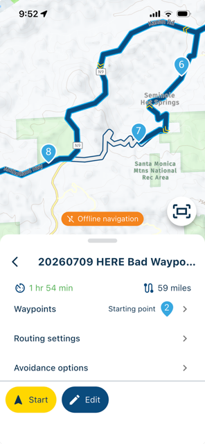

                                    @Brian-McG I thought you might find this interesting. I got out to test executing the route using my new Garmin Zumo XT3. Like MRA at waypoint#7, the XT3 recognized that the actual road did not match the HERE generated route. Zumo XT's have an Off-Route Recalculation option that essentially stops routing until the route rejoins the actual road, which it did further up where the road straightened out. The route re-started automatically with no intervention required on my part.
                                    At the same time (side-by-side), I executed the route using the MRA Phone app. I had been playing with Nav Functional settings on the app to try to correct the "turn around" behavior from my first attempt. I enabled the "Skip Waypoints automatically" hoping it would ignore WP#7 and continue onward to WP#8 as it normally would. Well, that didn't work like I thought it would. The skip didn't kick in immediately. It wasn't until I was almost on top of WP#8 before I got a message, and then when I passed WP#8, the app tried to turn me around back to it. It was getting unworkable, so I stopped the route on the app altogther.
                                    I'm going to change things up on the app again to try to get a successful run through that segment:
                                    1. Switch to "Offline Navigation" from Online -- I don't know if this will change any behavior, but it's worth it to see if anything changes.
                                    2. "Skip Waypoints automatically" turned OFF -- Maybe a manual skip when the problem with WP#7 first appears will give me a clean path to waypoint#8.
                                    3. "Automatic recalculations" -- I was considering turning that option ON, but my fear is that it will trigger MRA trying to turn me around. If all else fails, maybe I change that on a subsequent attempt.
                                    When getting ready to start the route on the app, it's clear that that it knows ahead of time about the issue:
                                    It looks like it has already decided to turn around at WP#7, and double back counterclockwise to the main road (Kanan Road) to reach WP#8. That's not what I want, but....
                                    Brian McG 1 Reply Last reply

                                      @John-S-Parry I know a bit about garmin routing, not a fan, ditched my XT2 because the recalculation function just does not work, but that’s another thread!
                                      What you describe is not surprising, if a point is a long way off a route most nav devices wont recognise that you have gone through that point
                                      It sounds like the XT3 is clever enough to recognise you are back on the correct path/track after you have passed point # 7 which is something MRA does not do
                                      Auto skipping of points in MRA is not perfect but it does sort of work,
                                      I believe it attempts to direct you back at least 2 or 3 times to a missed point, i.e. it will recalculate 2 or 3 times to take you back, if you ignore these new instructed paths 2 or 3 times then the auto skip function kicks in & the route calculation will resume heading to your next point
                                      In you case point #8 is not a great distance from point #7 & there are not many options for MRA to recalculate back to #7 before you hit #8 hence what you experienced
                                      as for your ideas
                                      1. this should have no effect on this issue
                                      2. I would recommend keeping auto skip on, it just requires a bit of patience to let it do its thing
                                        it would be better if MRA was as clever as a garmin / tomtom & recognised it was back on track but the MRA devs have not figured out how to do that......yet!
                                        the fact that points are sometimes missed by nav systems is just one of those things & is why remote controllers for phones running MRA are probably so popular, it is a quick lift of a finger & press of a button to manually skip a point
                                        I loved my Tomtom because it could only navigate tracks so no Via or shaping points to miss but that sort of track navigation also has its limits
                                      3. "Automatic recalculations" is for when you deviate from a route/track, it will try & recalculate a path back to the route/track, it should not really be relevant here but its worth experimenting, maybe point #7 is far enough off route that its considered a deviation if you stay on the road
                                      Interesting the app has recognised something is amiss, odd the way it has tried to resolve it
