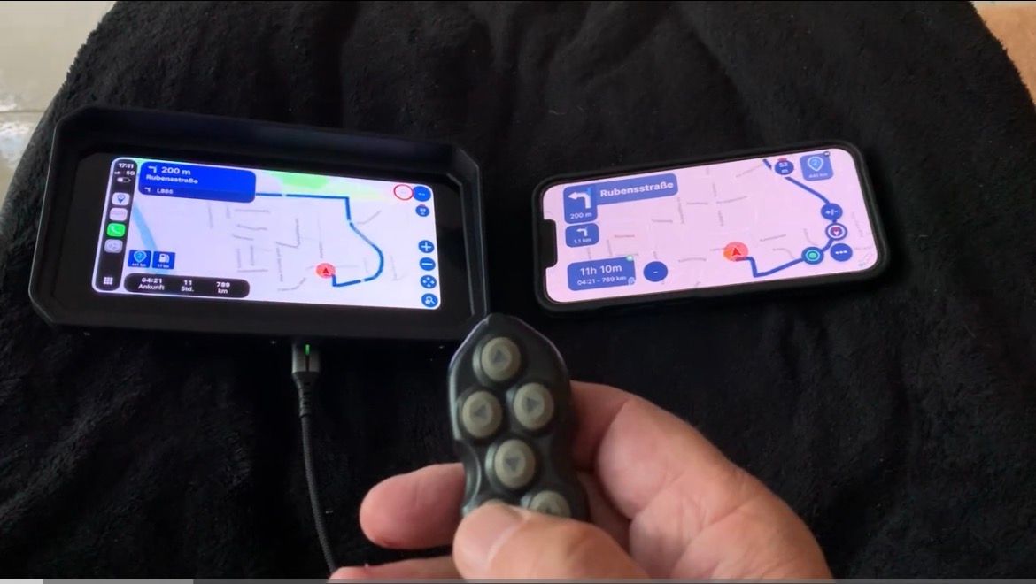

                Test it with the mobile phone display on, see the video. I have a Remotek One as a BT keyboard, but this application is not officially supported for CP / AA but works in this example.
                On the left a CP display and on the right iPhone Xr
                Link zum Video
