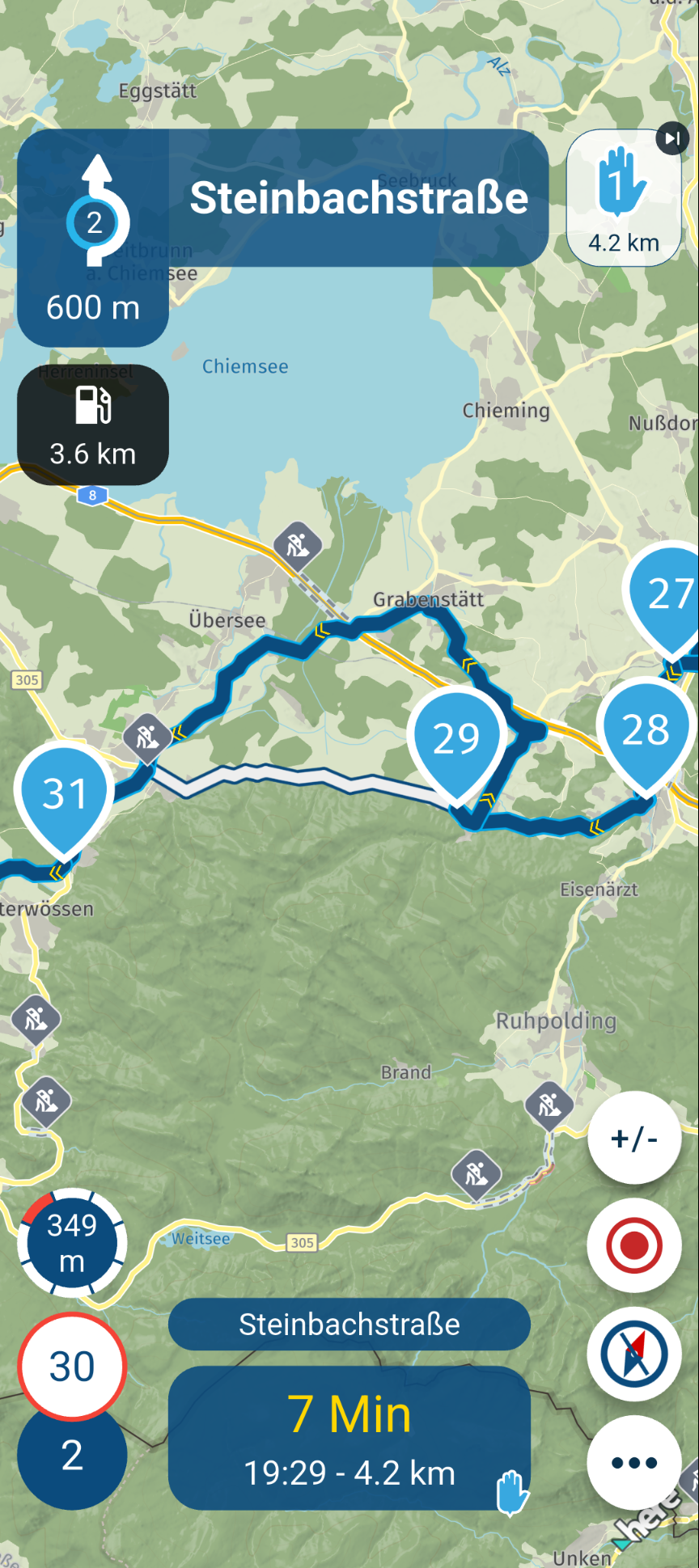

    When planning a round trip in the app, a nice route was made with 2 known route violations. Both were blocked roads due to roadworks. The mra said sent me over this road, did not provide a d-tour when we saw we could not pass and then it kept on sending us back to the same place knowing we could not pass. This was very annoying.
    @Metalhead, the app will not send you back because of the blocked road, but because of a missed track point. It will send you back maybe 2 or 3 times, and then give up.
    Metalhead 1 Reply Last reply

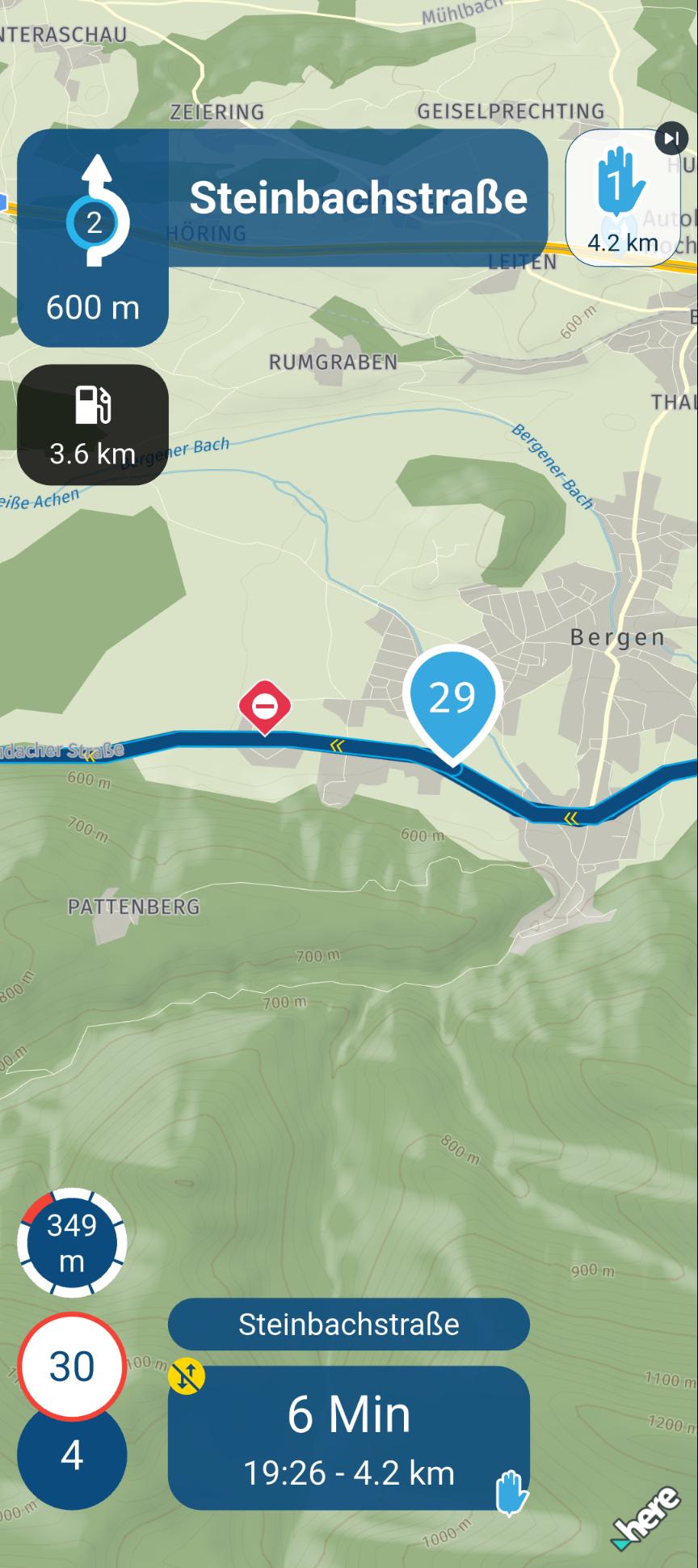

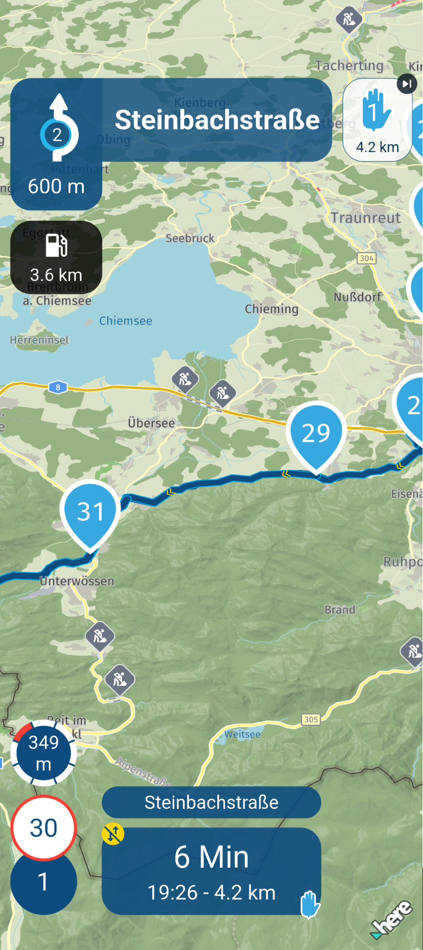

            The road block was visible in the map, the route info said there was a route violation due to the road block and the app kept telling me about the roadblock. The thing it did not do was not plan a route through the roadblock or provide an alternative.

              I've experienced this as well. During my long road trip last month there was at least one location where the app stated there was a known route violation road closure, yet it directed me through that violation anyway without offering a detour. I don't know if it would have tried redirecting me back through it, because I manually looked up the best detour route and changed the route to account for it.

                      @Herman-Veldhuizen I have noticed the following...
                      When I’m navigating online and Here is aware of a road closure, the app automatically creates a detour to bypass it.
                      However, when I navigate the exact same route offline, a message does appear to indicate the closure on the route, but the app does not automatically bypass it.19000.png 19001.png 19002.png 19003.png

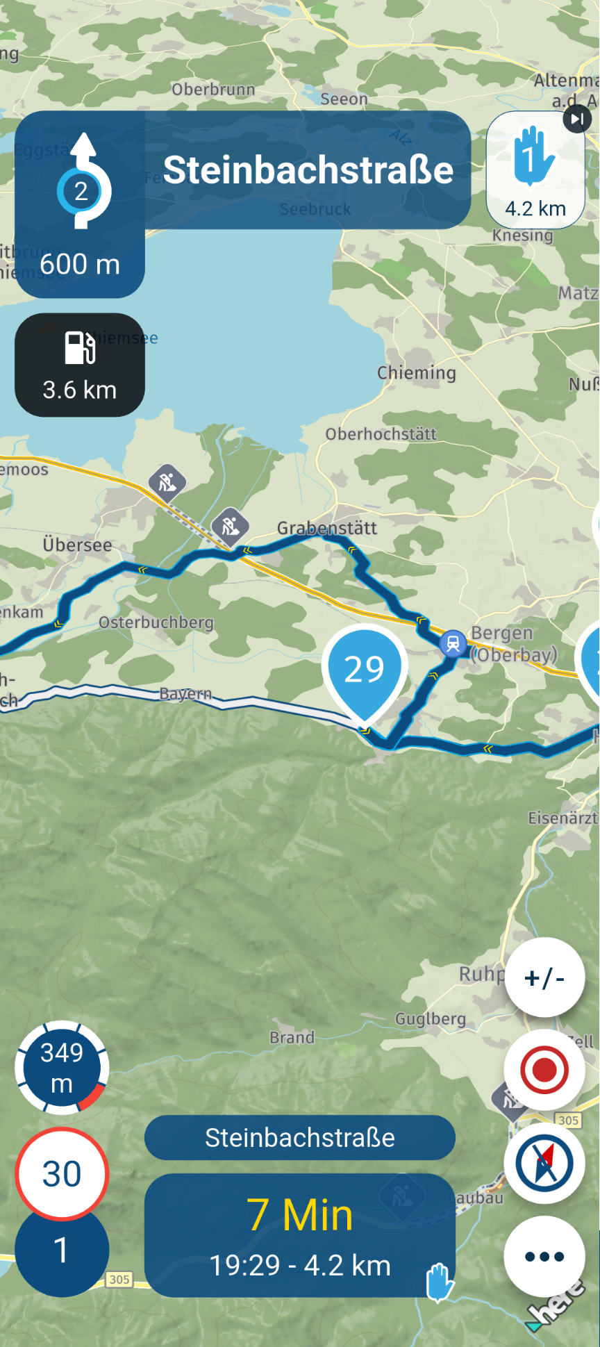

                                My issue is two old. First, the route is made through a known violation of the route and second, it kept on directing me through the road closure without offering an alternative. The app was in online mode and it was a route, not a track. I tried to skip waypoints, but could not find how to do so.
