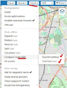

                          @Mike-wiruth as @guzzist suggests use lots of points to constrain the route to the path that you want to take
                          on the web planner you definitely want to be using "Compare" tool to ensure that OpenStreetMap & TomTom also follow the same path that Here is calculating in the MRA web planner
                          if TomTom or OpenStreetMap can find an alternative path you can bet that your XT will also find a different path to what you had planned
                          the XT is using a different path calculator profile to MRA even though they are both using Here mapsย
                          so any calculation done by the XT is possibly going to be different unless you force (constrain) it to the same path with as many points as it takes
                          & again asย @guzzist says you have to make sure the settings you have on the MRA planner match the settings on your XT as closelyย as you can
                          a rough guide that paths are closely matching is to make sure the mileage for the path in MRA is similar to the path on the XT
                          it is not a perfect check but if the variation is small, chances are more likely the paths are more similar
                          it is a lot of work trying to coral an XT to stick on a path you want to go & ultimately the XT will defeat you
                          you will be taken off your chosen path, I know from bitter experience
                          yes the search & poi capabilities on a Garmin are far better than MRA, especially when it comes to things like finding petrol
                          but I would rather my navigation device actually navigates exactly the path I want to go (MRA navigation does this) & sacrifice the nice feature of being able to find restaurants or hotels etc
                          after all we do have google for that sort of thing
