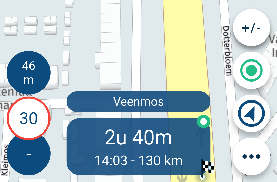

    The current beta 5.1 does have an extra icon for the altitude. But in my case it does not match the real altitude.
    Some other apps i've tried show the real altitude.
    I live approx. at sealevel but Myroute shows an altitude around 46 meters. While the other apps show something like 0 or 1 meter.
    When i ride over a bridge the altitude is climbing and the difference on top of the bridge and back down seems good. So somehow the startingvalue seems wrong.
      We indeed received some reports that different Android devices seem to report a wrong altitude.
      Will be investigated.
      I know this sounds weird so unsure how that then works in the other apps but we literally just show the altitude as received by the GPS without any correction.

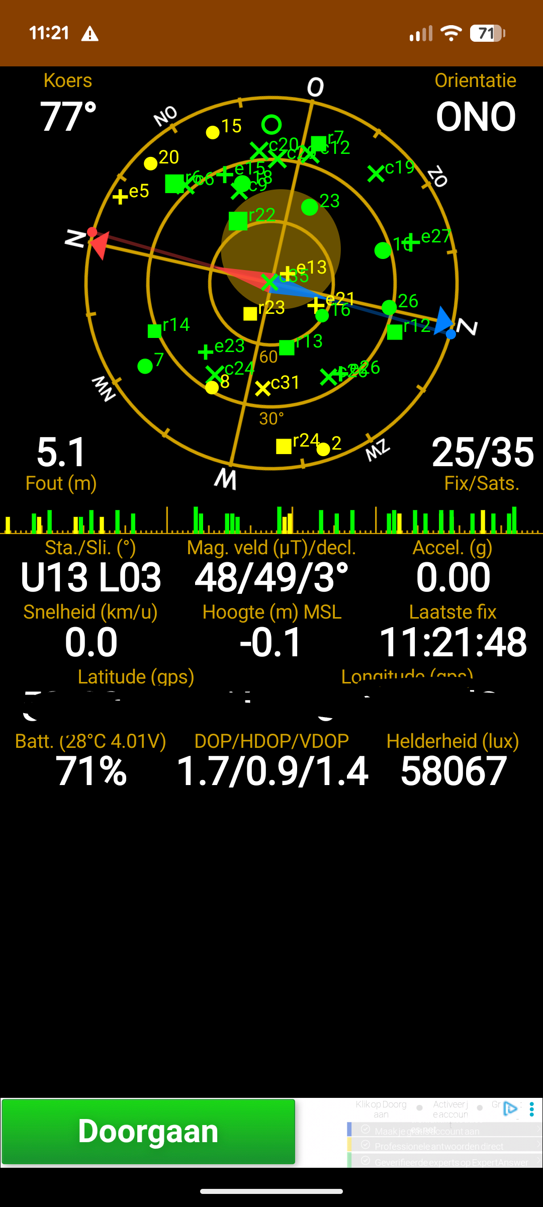

        • M. Schrijver
          Just for comparison.
          Altitide according MyRoute:
          Altitude according random GPS Tool:

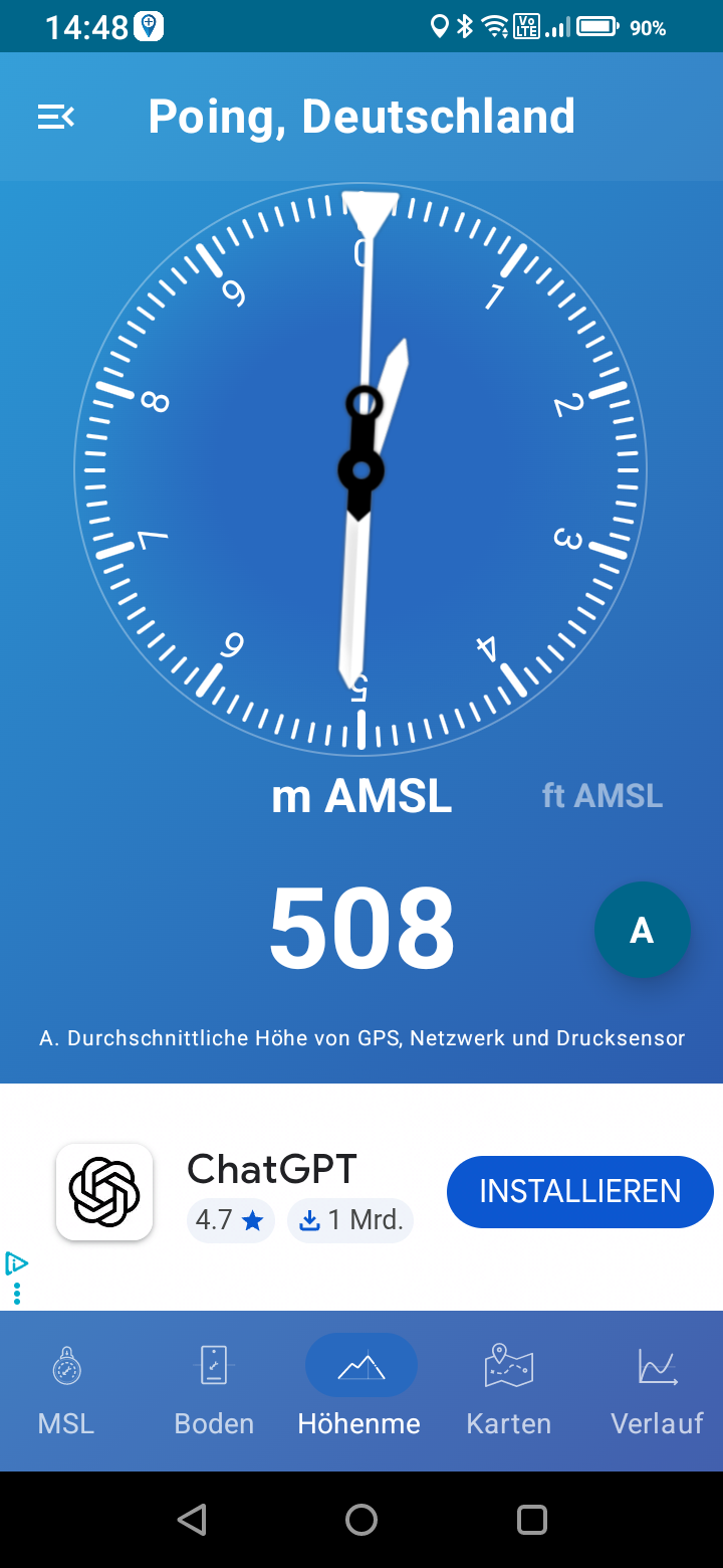

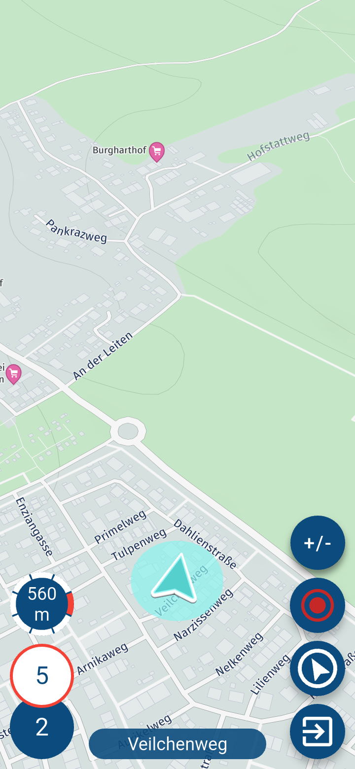

            Habe dasselbe Problem: Die Höhenangabe in der MyRouteApp, Vers. 5.1.0-462, zeigt ca. 50 m höher an als der Barometer und Höhenmesser auf demselben Smartphone (Gigaset GX 4Pro, Android 14), siehe Bilder.
            Die Höhenmesser-App ermittelt die korrekte Höhe von 508 m üNN aus dem GPS und dem Drucksensor des Smartphones (Sensor: Bosch ICP101XX).
            Navigation: Gigaset GX4 PRO, Android 14
            BackUp: Google Pixel 7a, Android 17

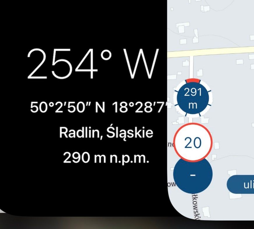

                I can see the same on my Iphone 15 - compass app vs MRA:
                Regards

                • M. Schrijver
                  @stanisław Maybe i look wrong. But in your screenshot MRA says 291 meters and the other app 290 meters. That is within limits.
                  Or am I wrong?
                  • Stanisław
                    I meant that they are the same values in both applications, so I can not see any problem on my side.
                    Regards
                    Staszek
