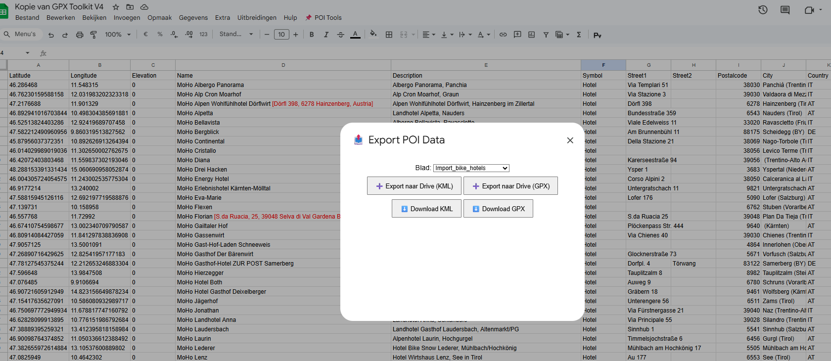

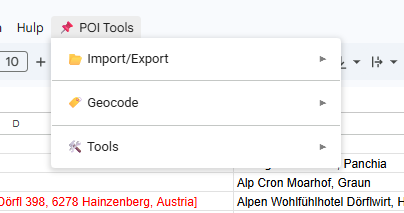

      I have ran into the same problems that you did and started out using Excel to edit POI, as I also use a Garmin device and wanted to have more fields available. After some time I switched into Google Sheets because I wanted to access POI also when I was not at home.
      This can be accessed "In the Cloud" and can be programmed with Javascript instead as Visual Basic in the Excel version. Downside is that you must have a Google account.
      With javascript I progammed an Import/Export function for GPX/KML files, can Geocode coordinates in the way as Garmin uses the fields and also add addresses into the name field so I have the address in the MRA POI available.
      Import in MRA I do with GPX as CSV will not always importing correct into MRA

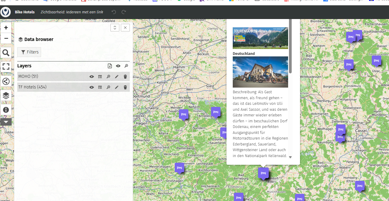

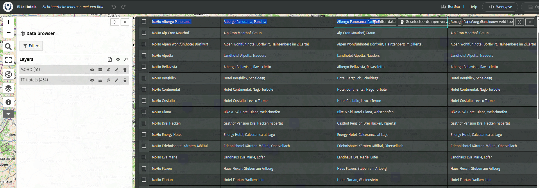

      Instead of Trello I use UMAP, that runs on Openstreetmap, for managing POI as it can also import GPX and you can manage into POI catagories.
      My workflow is as follows:
      Import or add data on Google sheets --> Edit and export GPX --> Import into Umap to check, edit in Google Sheets --> export GPX --> import in MRA
