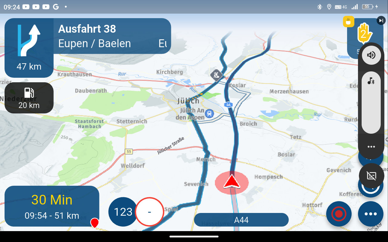

    questions regarding displayed information.
    1. What does the "Play" symbol mean (right side of WayPoint)?
    2. What is the red "dot" for on the kilometer/time info?
    3. Should the red dot not be yellow as the hand in the Waypoint Info?
    4. Why is the 30 min. information yellow?
    Thank you!

      @Jörgen
      1: you can skip (just a hint you can tap it)
      2: that you’ve chosen to display ETA / distance to every next shapingpoint (and via) rather than finish or only via
      3: the next shapingpoint is the indicated colour but I guess this a very nice edge case where indeed yellow would be the correct colour to display (as the time / distance is for that via)
      4: minor traffic

        Here's how I would interpret it: The upcoming waypoint is a VIA point, coloured yellow and is WP #2 (indicated by the yellow hand icon in the top right).
        The indicator in the bottom left refers to the next shaping point, coloured red, which is beyond the next waypoint and has #3 or higher (as the next WP is VIA #2).
        Am I making a mistake here?

          @Martin-Wilcke you are not wrong but when selected upcoming waypoint it just shows the ETA / distance to any next waypoint (shaping OR via).
          Therefore it should be via now.
          The distance and time to the waypoint matches the yellow via but the color is actually that of the shapingpoint after the via 🙂

            Ahh, ok, got it. I let that symbol (drop icon) fool me 🙂
