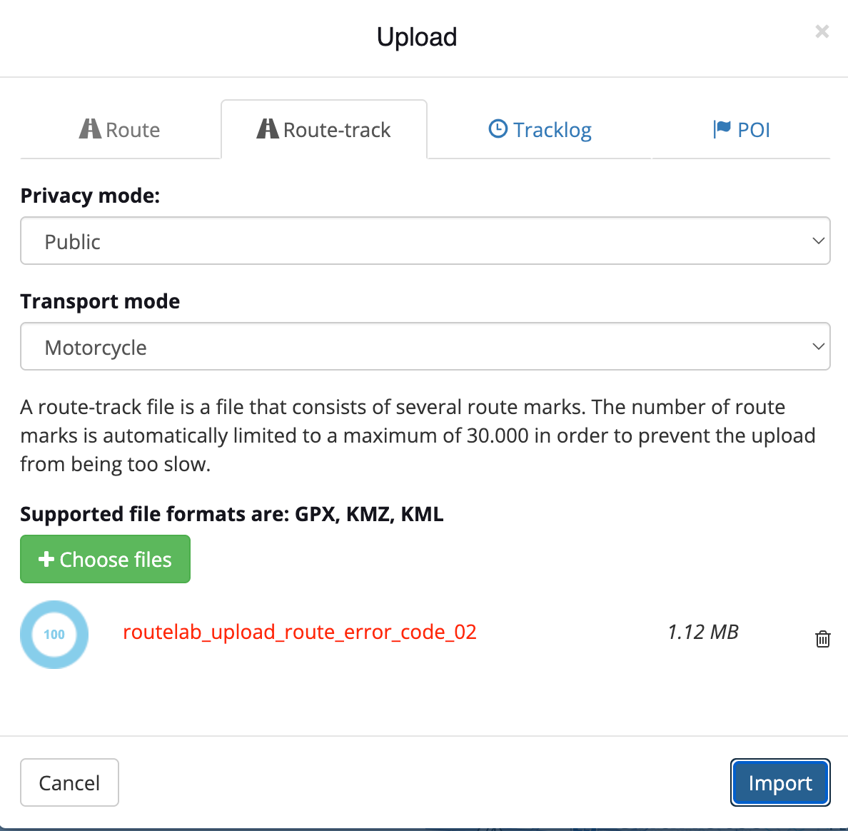

    I have a a KMZ file that I exported directly from a custom Google map that I am trying to import in MRA. Below is a screenshot of the error message I am getting when I try to import the file. I have tried as a route, route-track and tracklog. All result in the same error.
    Here is a Google Drive link to the actual file.
    https://drive.google.com/file/d/1xrCVMpPAeaM_LSECay72YdtsqNRNM-zM/view?usp=sharing
    I've made no modifications to the file exported from Google. Any help would be appreciated. Thanks!

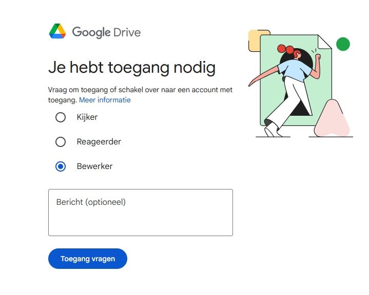

      I get this message when I try to view the file!

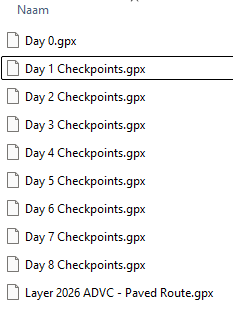

          @Kerry-Lebel, I tried to import as route, and it does that without issues. It is just that between the route points a route is calculated that is likely not correct. Importing as track leads to the error you mentioned indeed. What I did was convert the KMZ to GPX at https://mygeodata.cloud/
          Conversion leads to a multi day folder with individual GPX files with checkpoints, and a single complete track GPX file that all import just fine.
          I think the culprit here is that MRA import can't handle multiple segments in one file.

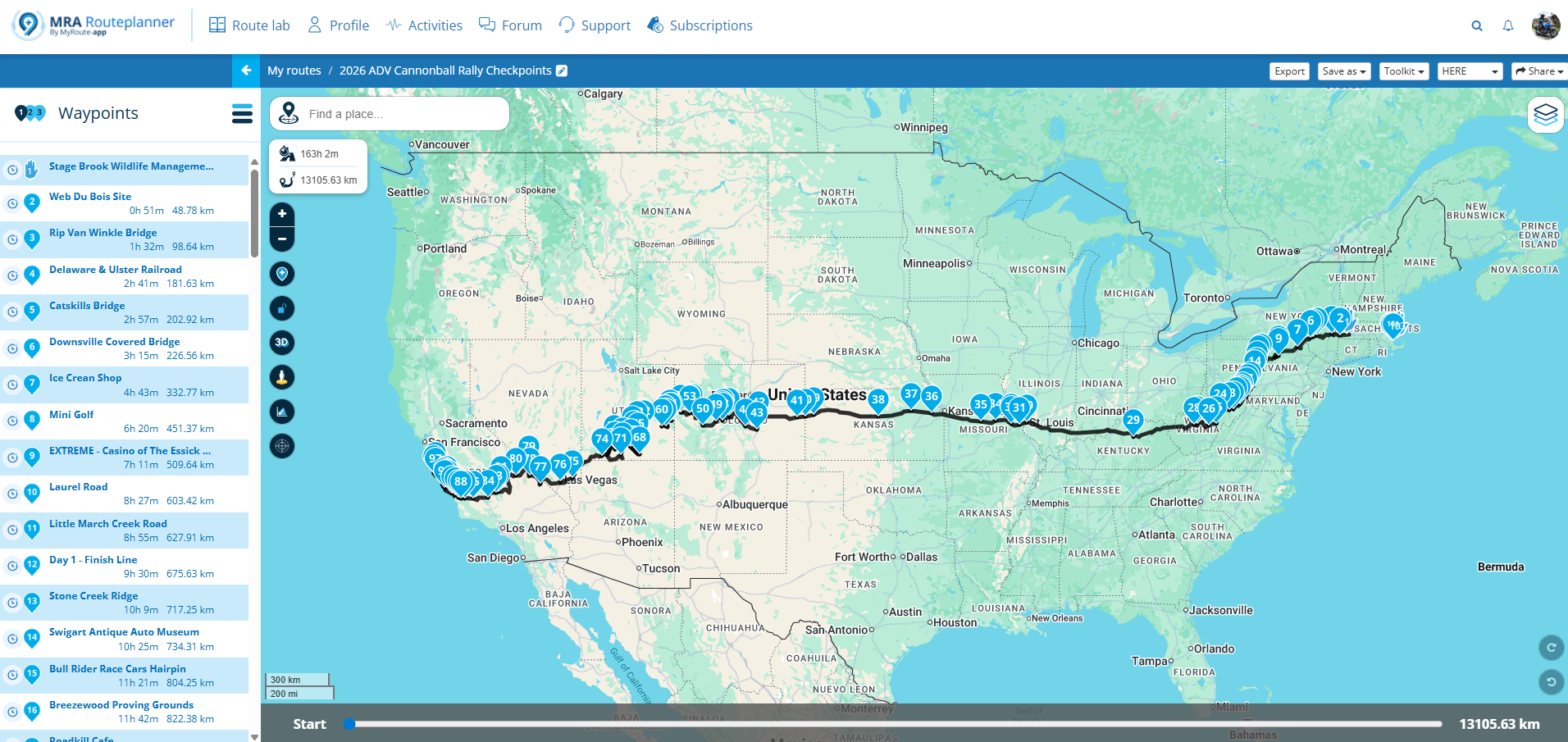

            @Kerry-Lebel for me the import works perfectly without any issues

            • Adrian Avram Adrian Avram
              Kerry Lebel
              Kerry Lebel
              Kerry Lebel
              @Adrian-Avram can you tell me what your process was please? I still can not get it to import without following @Con-Hennekens (thank you Con) extra steps converting to a GOX file first.
              • Kerry Lebel Kerry Lebel
                @Kerry-Lebel said in Error 02 on import:
                Sure.
                https://drive.google.com/file/d/1FRwnbuSFrU2YWDEysqEP6DE_ODRlngGp/view?usp=drive_link
                Adrian

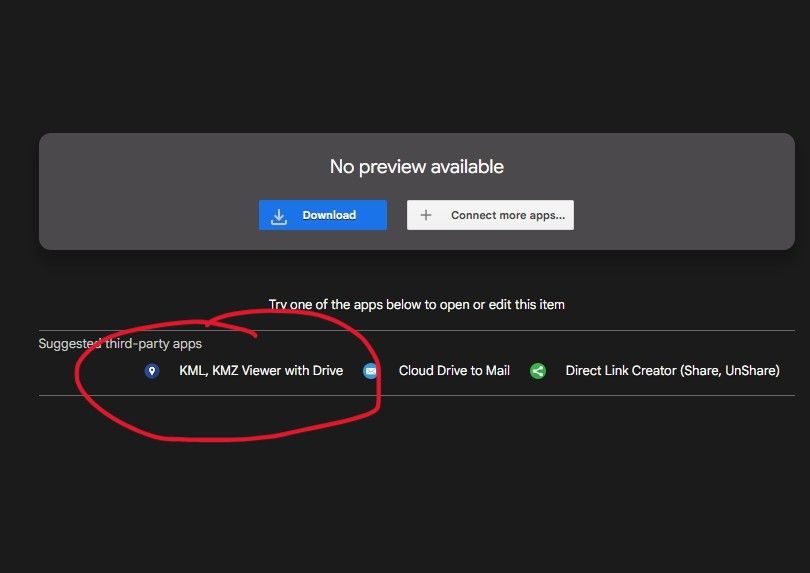

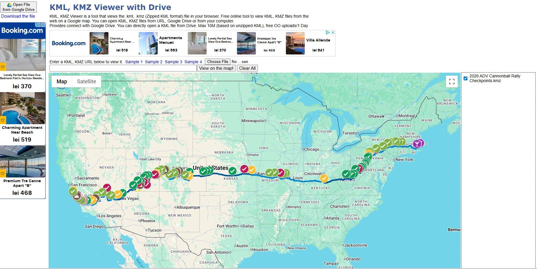

                  @white.mouse in order to view it directly from Google Drive, you need to install an addon.
                  wich looks like this after opening directly in Google Drive:
