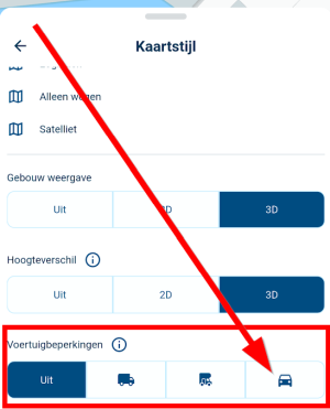

        @Next-Stop, Whether the restrictions are showing or not, depends on this setting:
        and the actual chosen mode of transport. If you set this to car (arrow) the restrictions will always be shown. Clearing cache and data probably reset your settings to default.

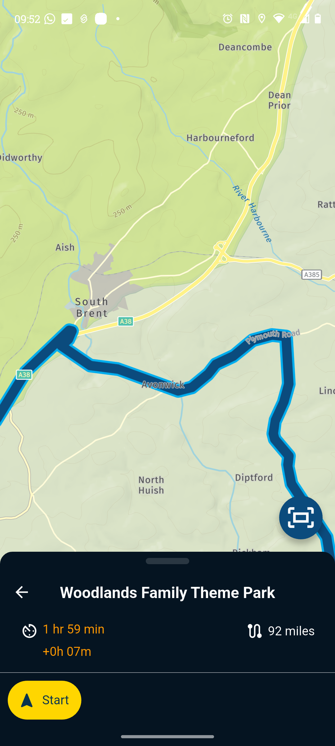

          @Con-Hennekens ah, excellent thank you! That has brought them back on the map layer, the navigation is still choosing to ignore them though sadly, hopefully a fix will come soon!

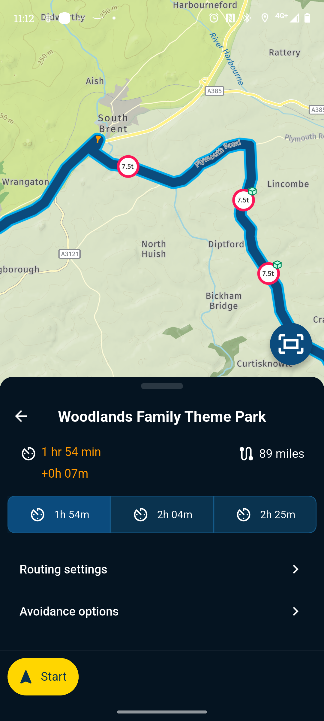

              @Con-Hennekens Funny enough I have just tried that and it seems to be working, looks like there must be a bug with the Motorhome choice as it's not recognizing the restrictions. Strange?!

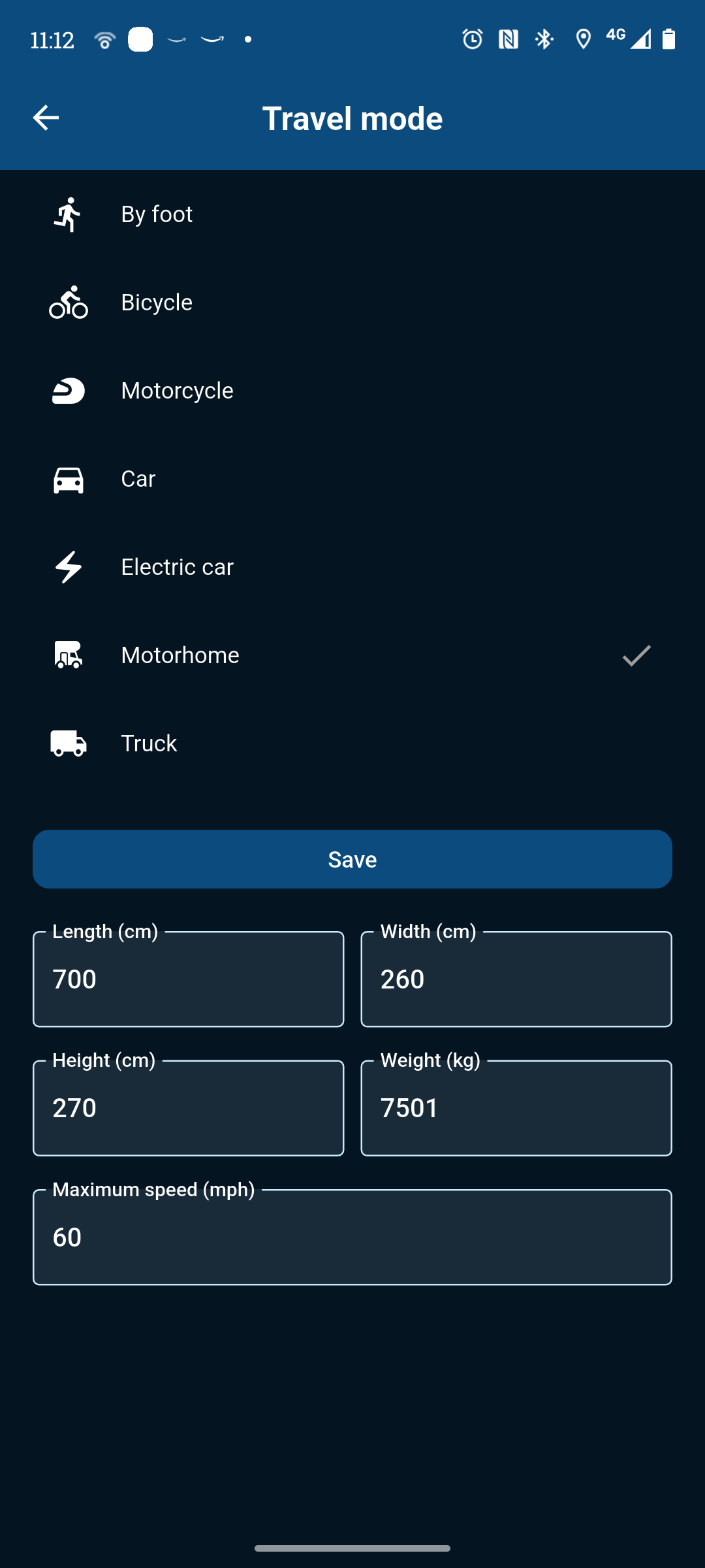

                  My MH is only 3500kg, but I've set it to 7501kg as I'd prefer not to travel if the road is tight and I feel that 7500kg limit fits better as I've come across loads of 3500kg roads that are no more than farm lanes!

                      A motorhome with a certain weight entered registers you as "big car" with a weight of something. Technically that road is only blocked for trucks of a certain weight.
                      So these really heavy vehicles should be entered as truck!
                      The real answer is that above 5000kg you aren't classifying as car anymore but you should be a truck. But as you selected a motorhome we just think of you as a big car ๐Ÿ˜‰
