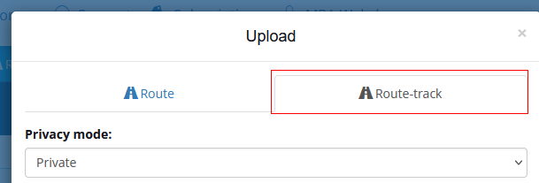

      If you wish to import it as a route track, do a new route upload:
      ...and select the Route-track tab.
      Select your GPX file and upload it.

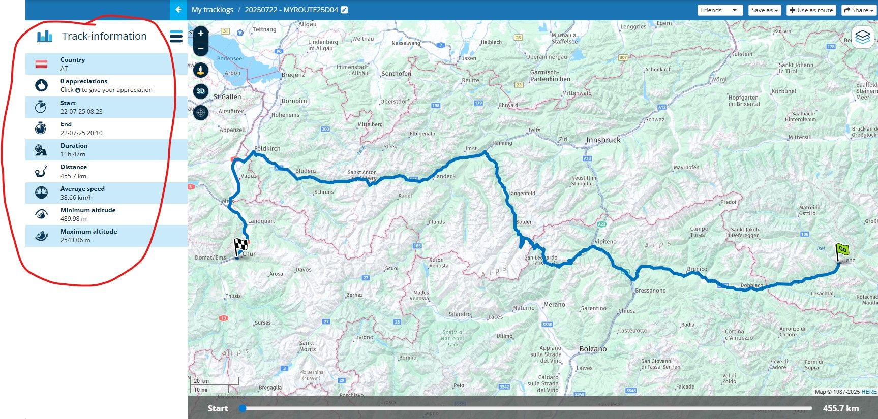

              You can see the information that a Tracklog has within the GPX file.
              Adrian
