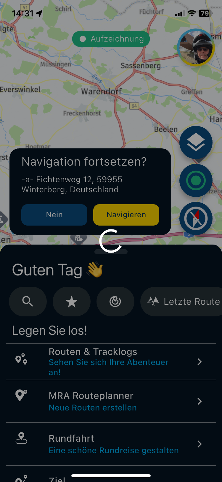

    Hello dear successful MRA team,
    The app is just great, I just noticed the last little point.
    Test - Route / RoutesTrack:
    If I start a navigation from A to B in the app, which I select as B via "Search for a favorite or a gas station" ... Then it starts directly via navigation. ✅
    Noticed: on the route
    Now I deliberately stop the route, then picture 1 is not offered to me. The route is stopped directly without the "No / Navigate" option.
    Wish:
    • It would be wonderful if you still had the option.
    Noticed: at the routeTrack navigation
    • Now I deliberately stop the route track, then I will be offered picture 1. The "No / Navigate" option can be selected.
    Selection: No
    • then stop the route track ... okay
    Selection: Navigation
    - Error navigation no longer works

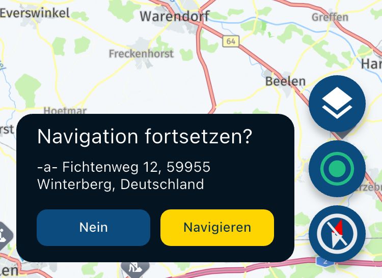

    - there was a calculation that does not yield a result, the process cannot be stopped ... s. Picture 2
    • it's like an endless loop / crash
    Solution:
    • App must be terminated / aborted with wipe (iPhone).
    Restart:
    The route appears with the menu picture 1
    • The option "No / Navigate" can be selected.
    • The same error is repeated when you press navigation again
    Picture 1
    Picture 2
      I could make a video if desired because the description seems incomprehensible.

              Ok, now I understand.
              A restart is not possible. I tried on my iPhone and saw the same problem.
              On Android, it is working.
                Sorry correction!
                I just updated Android.
                With V 422 it is the same on Android. No restart possible.
