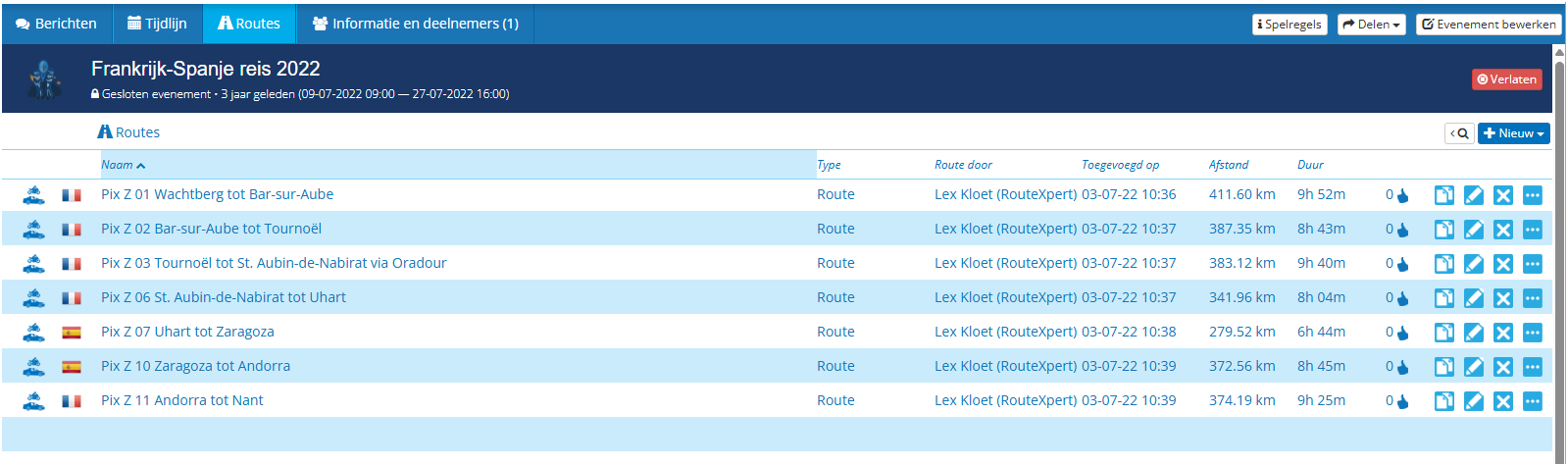

    Within a folder in MRA I have approx 12 individual routes that I created as options for a tour I organised. Now that I’m back from the tour, a few folks have asked if I can share the full tour as driven picking each of the individual routes we actually used on each day.
    Is it possible to ‘knit’ each route to the others to produce one big route without having to recreate from scratch?

      Why don't you create an event (leftpanel) and copy all the routes and/or tracks in that event. Invite your friends into this event and you can also send messages in this event.

        Thx Lex.. I’ve asked the question because I’m also writing an article for a magazine. The editor has asked for a high level, complete route map. I know which of the 12 individual routes I created were actually used on each day- just trying to “add” them together to create one complete 7 day route

          Simple, open the first route, on the left side menu select Routes. Now add the route you want to merge with the first route. The route will be displayed. On the left side menu you will see the route listed. T9 the right of the route you will a "X" and below it is a "+". Click on the + to merge 5his route with the first route. Do this for all of your routes.

              Thanks again RWM, I’ve managed to stitch all the individual routes together. One small issue is that the first route still displays all the waypoint icons which obscure the high map picture I’m trying to create.
              Can I edit that first route to hide the waypoint icons?

                @Roger-Needham-0, do it all again, but start with an empty route 😉
