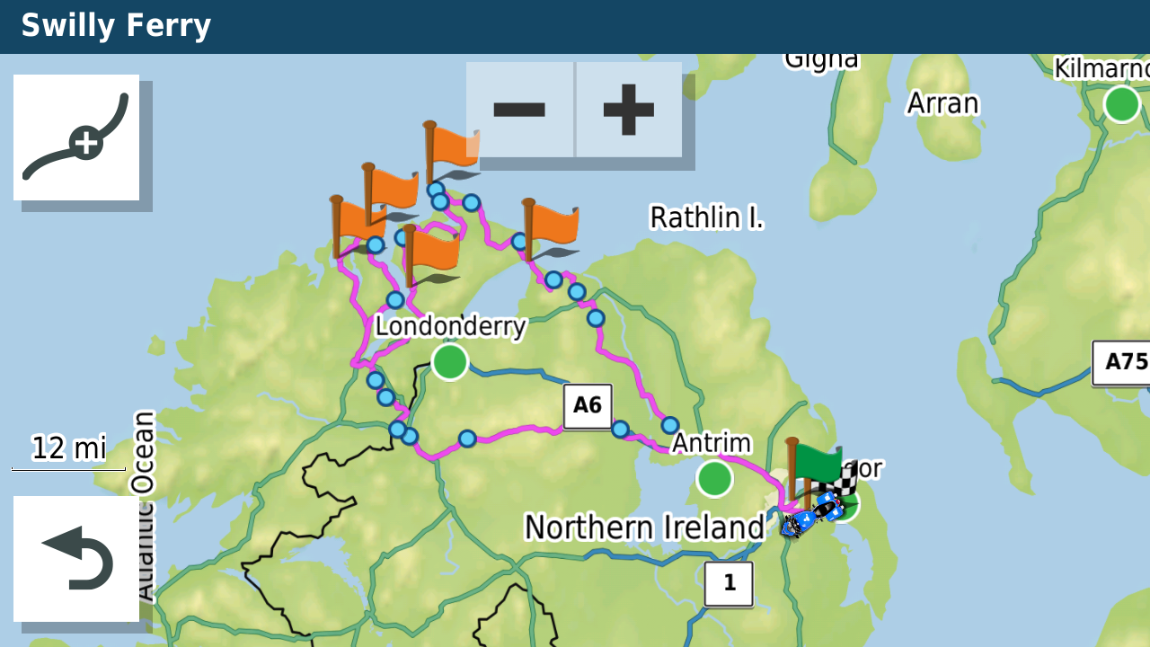

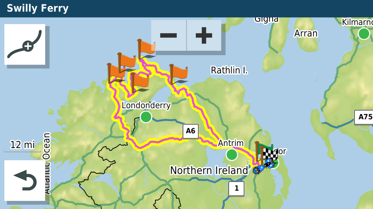

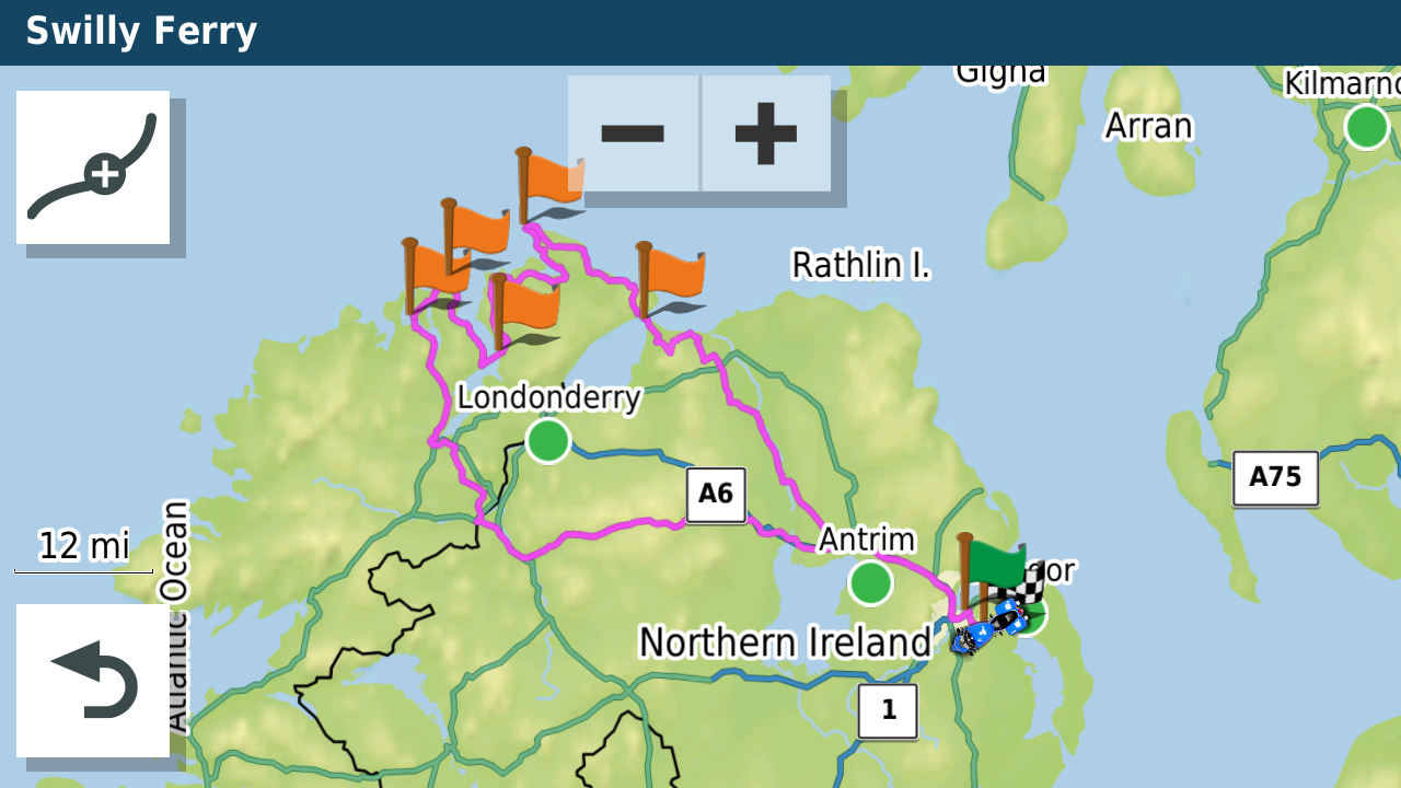

        The xt will import viapoints/waypoints as flags from MRA and shaping points as blue dots if you import the route as GPX 1.1 but it will recalculate the route so make sure that you put as many shaping (waypoints) as required to stick to the planned route. If you enable track visibility in the XT you can see if the recalculated route has been modified from the intended route. To enable the POI to be seen on the XT it needs to be included as a Waypoint in MRA not just as a POI. If you use GPX 1.2 switch off automatic recalculation as if you go off route the unit will take you to the next Via point of the end of the route (if there are no via points between your position and the end). But depending on your XT settings it might take you on main roads when your intention is to take backroads. That's why I use GPX 1.1 as a recalculation will enerally take you to the next closest shaping point.
        • Mzokk
          GPX 1.1 On a Zumo XT
          GPX 1.2
          GPX 1.2 with a track enabled underneath it.

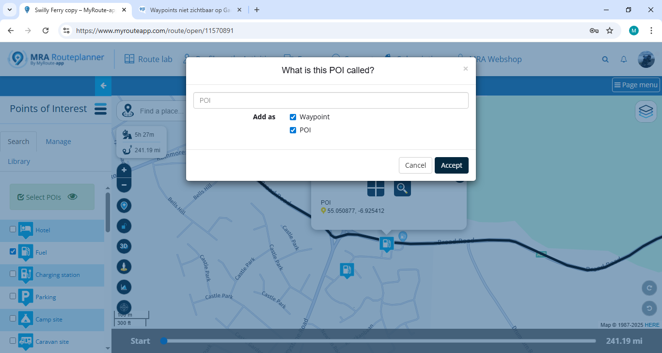

                  I see only via points, you can add POI’s via the left menu. Go to points of interest en check these who you want to see. Then zoom in on the map and Rick + to add a poi to the route

                      Nee, dat wordt getoond als een vlaggetje, je kunt natuurlijk wel een POI toevoegen aan dat viapunt
                      • Travellexxie
                        Dat bedoelde ik dus, je hebt alleen een viapunt aangelegd. POI's aanmaken is een extra handelingen zoals mijn grote vriend Hans heeft beschreven.
