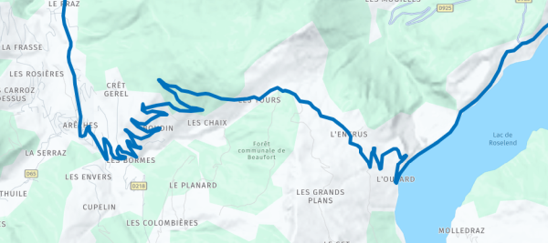

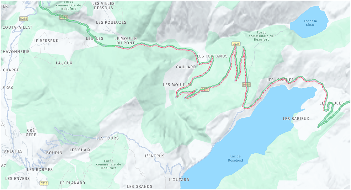

    The app is creating long and unnecessary detours between waypoints. The distance between waypoint31 and 32 is a few kms but as you can see a huge detour has been introduced and no matter how close to each other I put the waypoints the same detour occurs. I am familiar with the road and there is no reason why it can not be used.

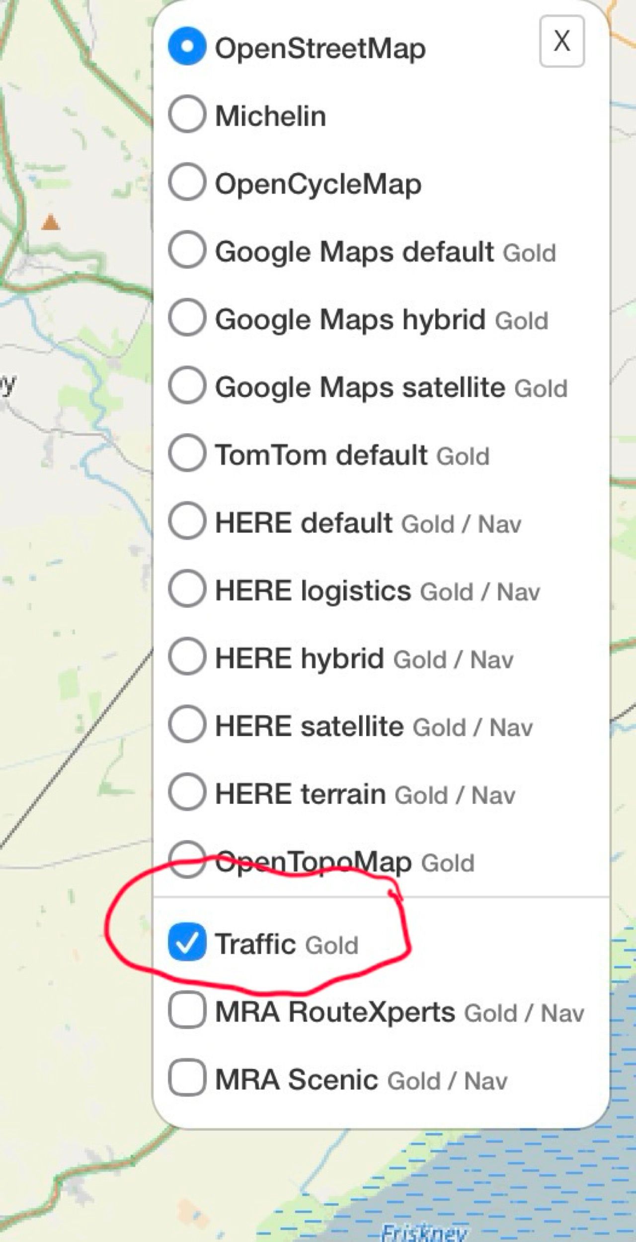

      Turn on traffic layer in the layer options and zoom in

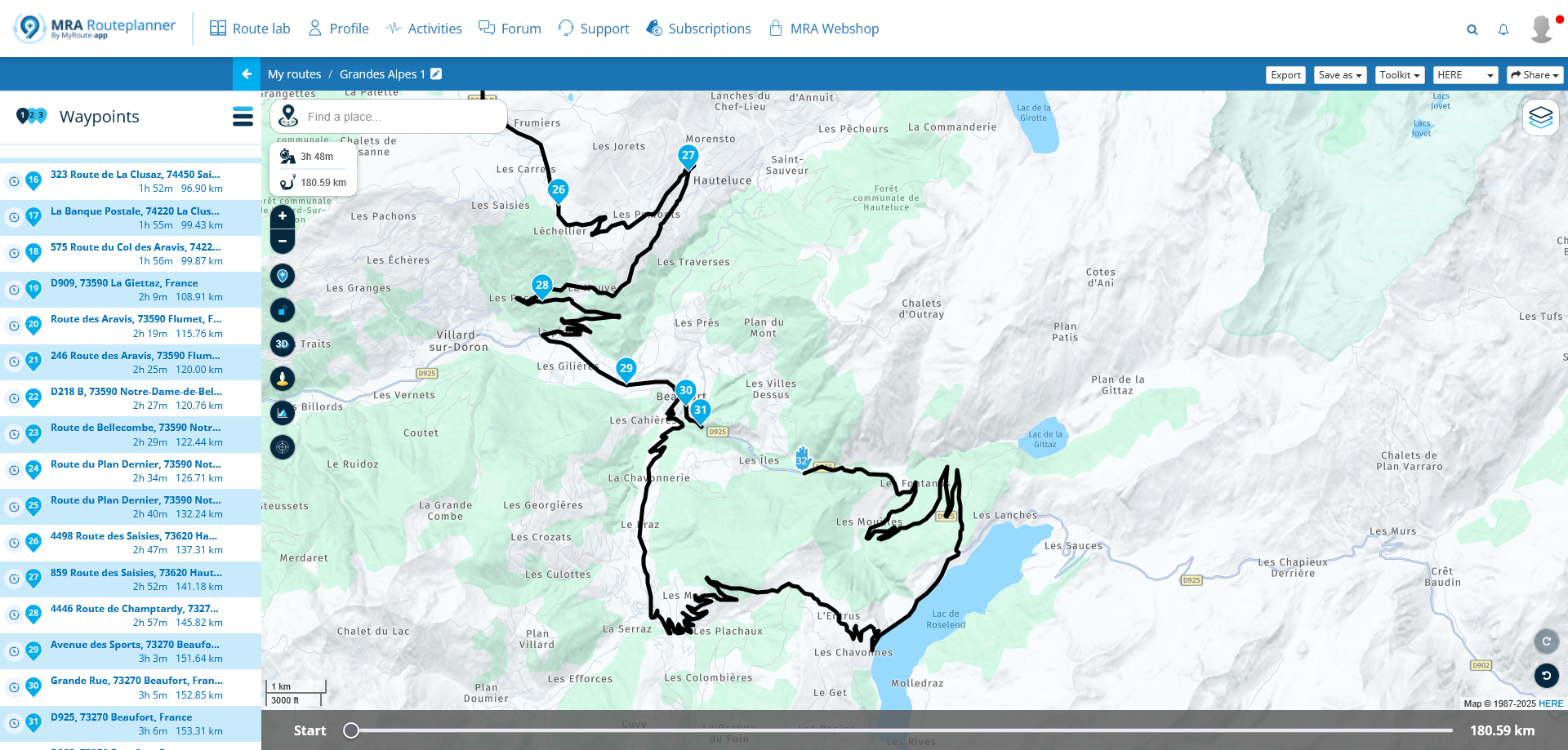

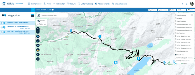

        Maybe the is a restriction between Wp31 and 32.
        Please check according the screenshosts.

          Share a link to the route and someone may be able to explain the issue. It's most likely a problem with the map provider.
          • Travellexxie
            Road is closed

              @ferrand24gmail.com everything has been said but on top of that, the detour seems like a great route to ride. Have fun
                Hey, The road is apparently open again!

                          Thanks for all the replies. The closed road was not shown on my computer screen but it did show up on my tablet. However it does appear that the road is now open, I'll have to wait till Monday to find out.
