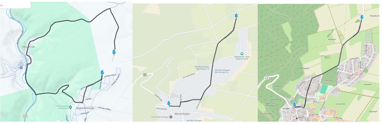

    Trying to get a old route into MRA.
    I try to get the route around point 24 going down, but HERE refuses to do so, TT and OSM route the way I planned.( going down and up again.)

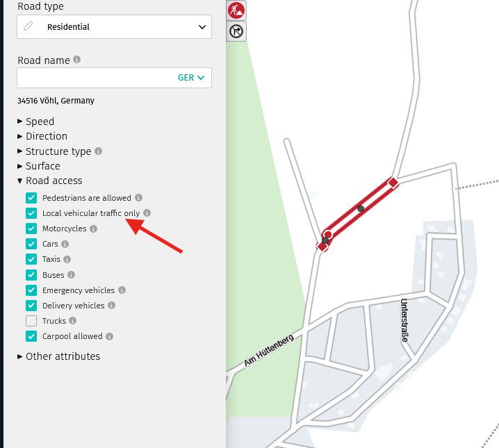

        @BertM the data for the Here map is different on the loop to the north of Marienhagen
        the Here map says it is not possible to pass
        this appears to be because the Here map has a small section of this road marked as "Local Access Only"
        maybe the road priority has changed & Here is correct & OSM & TomTom are wrong
        the sure way to know is to physically investigate
