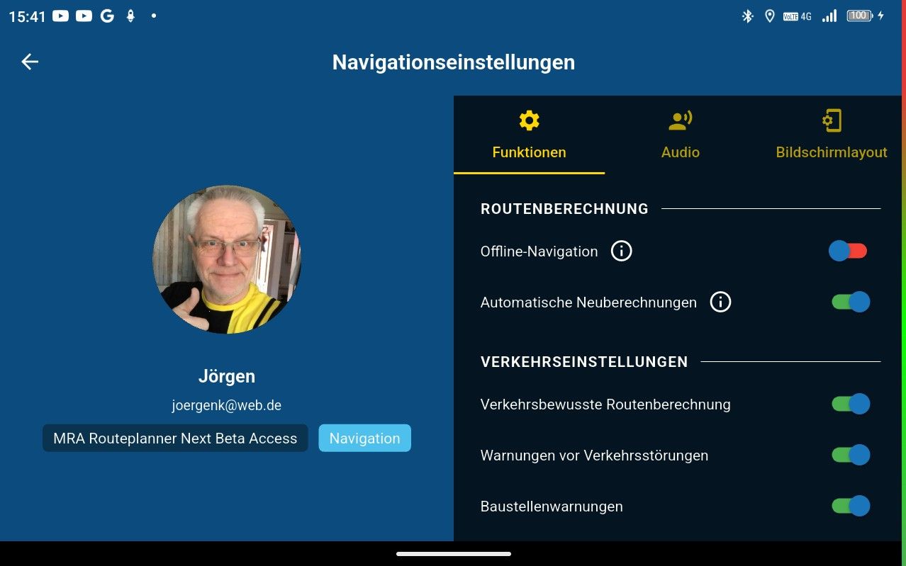

                I’m not sure if this is related to the same problem.
                I used the bar buttons again on my ride today. At first, everything was fine.
                After a long break, I couldn’t open the menu (Code N) any more.
                Instead, when I pressed the C button (Code C), this screen appeared?
                That’s actually supposed to change the view (like with the compass).
                  There is still something wrong/strange with the zoom via the BarButtons.
                  Sometimes the zoom works for 3–4 steps and then stops. You can keep pressing the button, but nothing happens. If you then touch the screen and move the map a little, the zoom suddenly starts working again.
