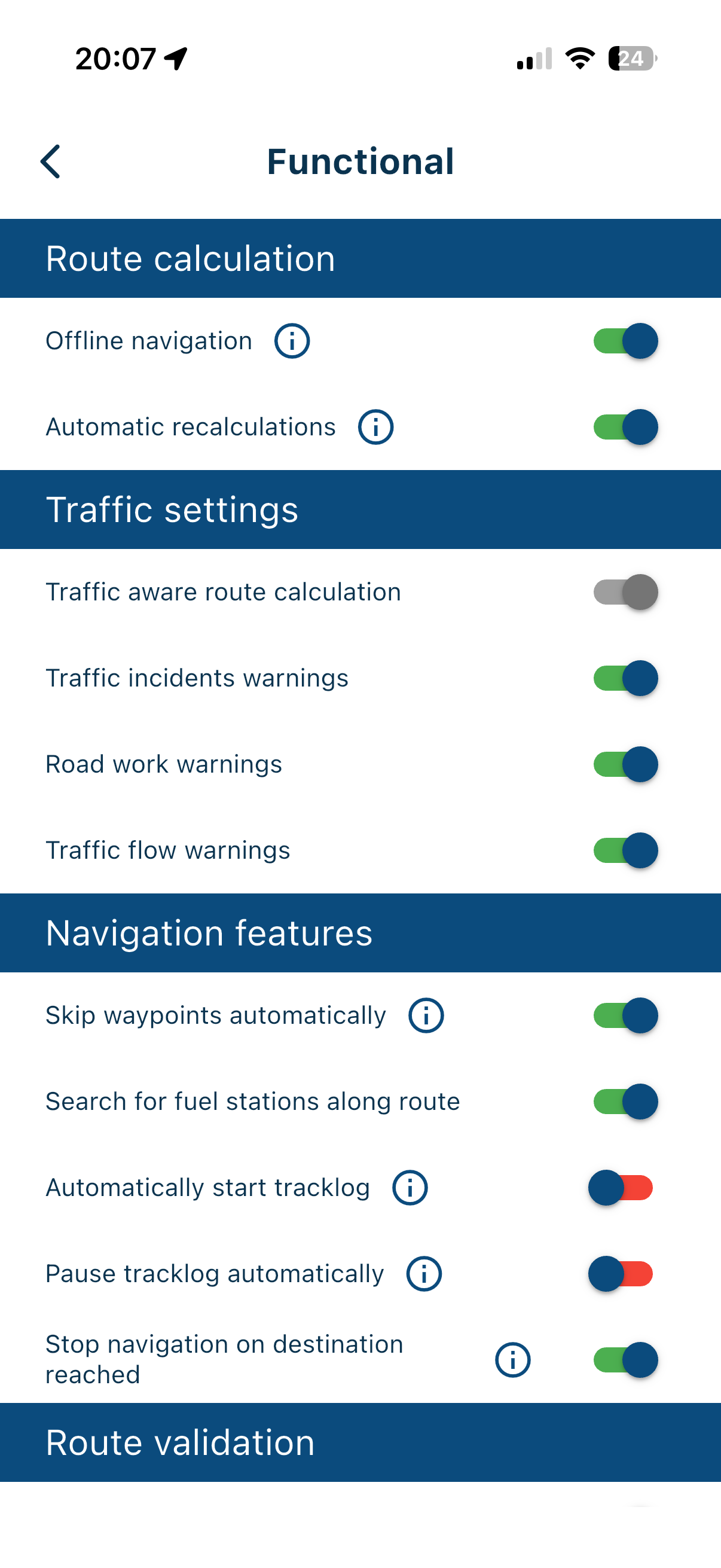

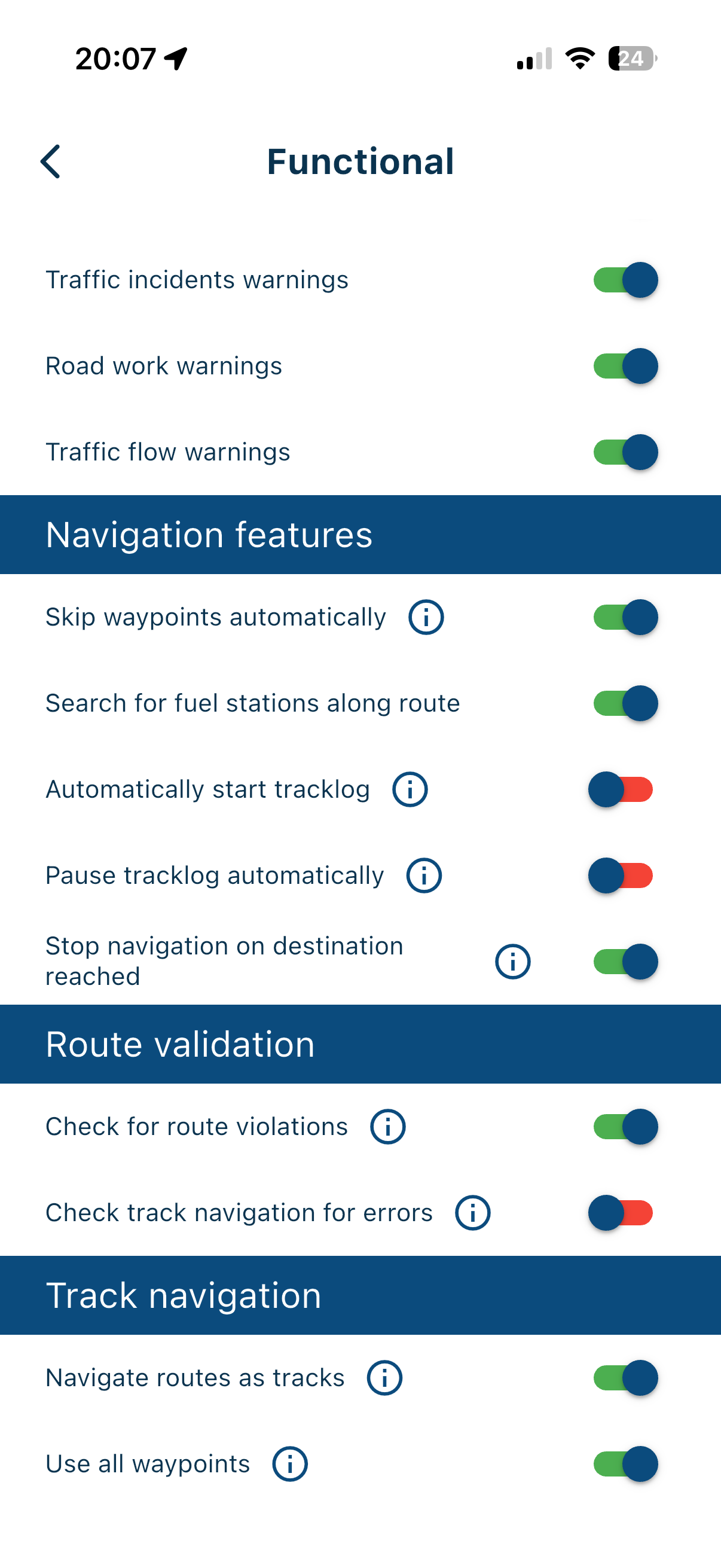

    Hi guys I just created a simple route from a point 100 meters away from my initial point and another ending point. When I tried to navigate via Apple car play the original route stayed intact but the app didn’t recalculate me from my deviation point to reach my destination.. any clues ? Thanks

      @Aggelos-Minoudis Have you enabled “Automatic Recalculation” in the settings?

          Probably untick "Navigate routes as tracks"

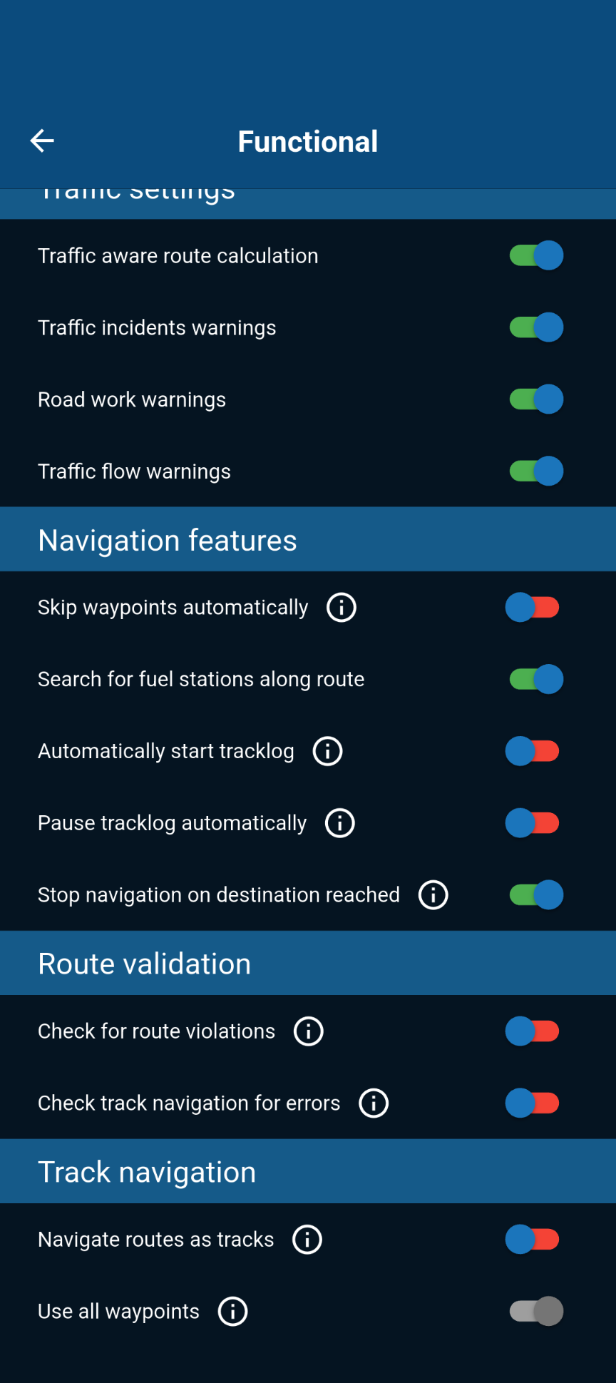

            @Aggelos-Minoudis Based on your settings, I can see that you're navigating offline using “Route as Track.”
            I think this setting is the reason for the issue you mentioned.
            Please try navigating using “Route as Route.”
            Please try these settings.
