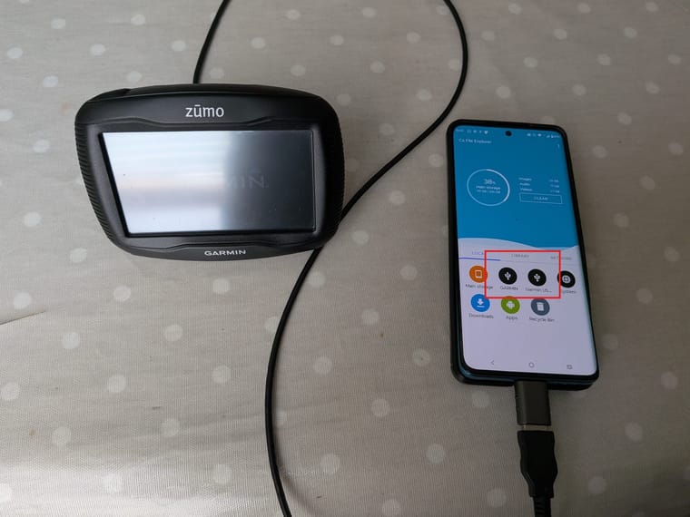

              • Mzokk Offline
                Mzokk Offline
                I don't use the connector. For my Zumo XT I use the Drive app (which has always worked flawlessly) or if the XT is connected to the computer I download the relevant files in my prefered GPX1.1 file format and put them into the Garmin>GPX folder of the Sd card in the unit. When you open "Trip Planner" on the device you can import the routes saved to the folder on the sd card to the unit. I use and old Zumo 390 and 340 on my very old R1150GS and obviously "Drive" does not work with these devices but the units have sd cards and transferring to Garmin>GPX works well. On the move all you need is your phone and a USB(A) to USB(C) connector to download GPX files to the SD card on these old Mass Storage device units.
