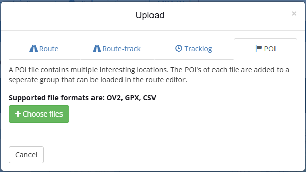

      @Greenham open the web planner, click the Upload button in top part of the planner and upload the file.

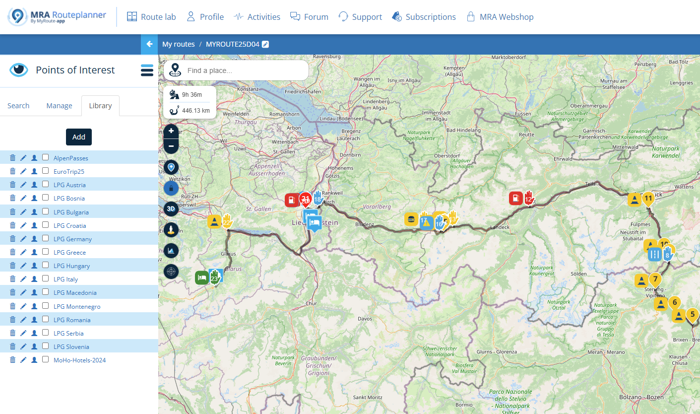

      When planning a route go to POI and Library and select the imported data base.
