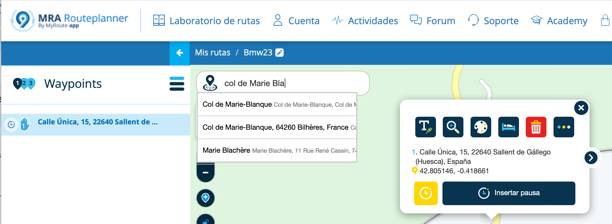

    • Suggestion list when searching for an address: I was on Sallent de Gallego (Col du Portalet). Our next stop was "Col de Marie-Blanche". trying to search on "search bar" was very difficult. an example that shows suggestions:
      Only appears when is almost writed:
      This happens on Web site and App. (IOS)
    So, I think that suggestions must be revised.

      Oddly the Navigation search works better.
      In the navigation app stop typing at 'Col de Marie' and it's the second result. Not bad.
      On the planner web site 'Col de Marie' returns no results at all for me, and you have to add the extra 'Ma' to get anything.
      That's faulty, I'd say.

        @richtea999 In my case, writing "Col de marie" no results for this col on 20 suggestions. Only appears after adding a "Bl". I think this is sorted by closeness to position.
          Apologies - I meant the extra 'Bl' not 'Ma'.
          It's still odd that the planner and app don't match (and the planner gives the worse result).
