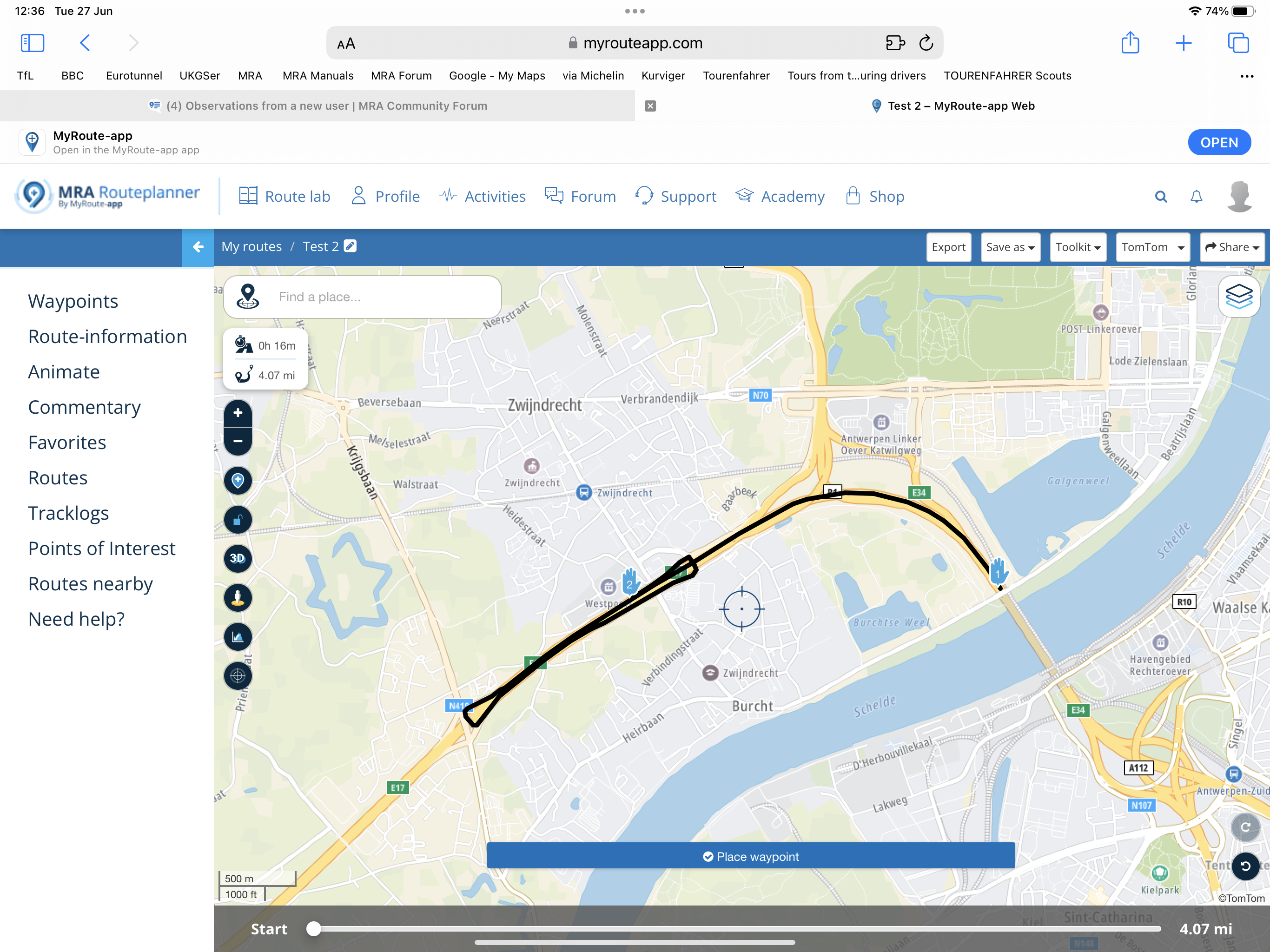

      I have tracked down the place in your second photograph and recreated what I think was your direction of travel.
      Using my iPad and the HERE version of the maps, my route did not deviate from the motorway. In other words, I was not taken off the motorway, onto a loop road and brought back onto the motorway again.
      Here’s two screen shots:
      Why your version deviated, might well be down to a number of factors.
      Richard 18 1 Reply Last reply
      • Richard 18 Richard 18

        In your first picture example.
        If you switch between HERE, TomTom and Default (Open Street Map) versions, I think you’ll be able to see that there is what appears to be:
        A. A big difference in the roads shown on the three different maps.
        B. What appears to be a load of road closures.
        I suspect that, depending on a number of possible variables, that you were routed correctly.
        I looked at the same very complicated junction in Google Traffic. Of course I can’t know exactly what it was like when you went through the junction but it’s certainly congested. I wonder if the app routed you past it deliberately?
        I guess it’s also possible, that the app at the time thought you were elsewhere in the junction (a possible GPS positional error) and routed you accordingly?

          Agreed there were a lot of works aroud the first above but the route shown was the one that was closed. Given the works this is understandable.
          The second one is just an example of many instances where the routing jumped off and then back on for no reason and having tried the various map options they all did the same. So this one is a bit more challenging to understand.

            On the second, the short route I created, does something bizarre if I switch into TomTom mode. But that itself is not unusual, as the base maps differ.
            Can you share your actual route file(s) with the forum, please. That way someone might be able to see what is going on.

              @DJP66 said in Observations from a new user:
              Routing leaves and immediately joins the motorway at junctions.
              This is typical behaviour if you base your routes on the OSM map and navigate them as a track.

                I have seen similar things when the avoid option is set on to avoid highways and you place waypoints on the highway.

                    I've had a chance to look in some more detail, I now think this is just to the different maps types when creating the route.
                    1. Market Garden HQ to Eurotunnel - Motorway.
                      This was based on the TomTom map and navigated as a route. It exhibited the off/on junction behaviour.
                    2. HQ to Hartenstein. This was based on the OSM and navigated as a track. It exhibited the behaviour
                    3. Hartenstein to Overlook. Originally based on OSM but I swapped just now in routeLab to Here maps and the route changed to ignore the junction as I would expect.
                    Therefore I've concluded that it is the algorithm associated with the map type. Now I have figured that out, I can work with it.
                    Frappawotsit 1 Reply Last reply

                      @DJP66 Keep in mind that when planning a route in any other map type (TomTom, OSM etc) than Here maps, when you navigate using the MRA app, it will only use Here maps. So you are likely to get some deviation between planned and navigated routes as it was planned using one algorithm but navigated using a different algorithm.
                      If you intend to use the inbuilt Navigation, always plan your route using Here maps. Only use other types if you're going to export the route and import on a matching map type... TomTom to a TomTom device for example.
                      One other possibility for your initial query regarding coming off and on motorways etc, did you plan your route using the "windy" option? Is it possible that it's taken you off the motorway and back on in it's way to provide a more windy route?
