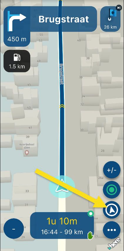

      Hello @conikost .
      Press the Compass arrow on your phone to switch between the available views.
      CP will folow the setting.

        This doesn't work for me. Pressing the compass arrow on iPhone does change the view on iPhone but not on the CarPlay display.
